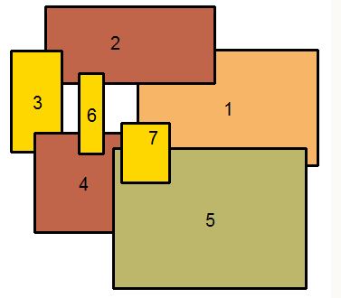

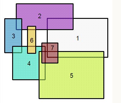

@I'm trying to assign my Watersheds polygon into regions of non overlapping polygons.

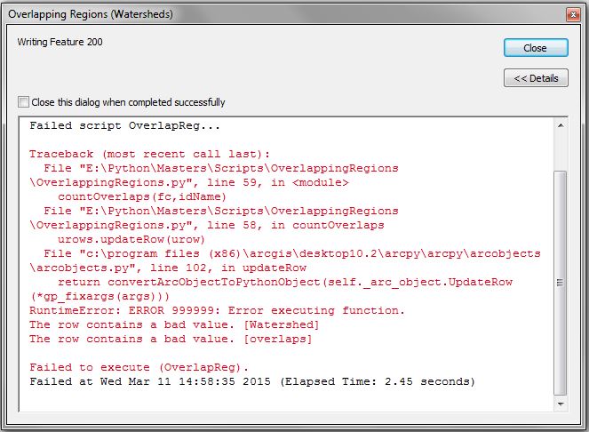

explodeOverlaps(fc,idName)but I'm receiving the following error message and I'm unable to resolve it. I'd really appreciate assistance in resolving the following as I'm still new to python.
