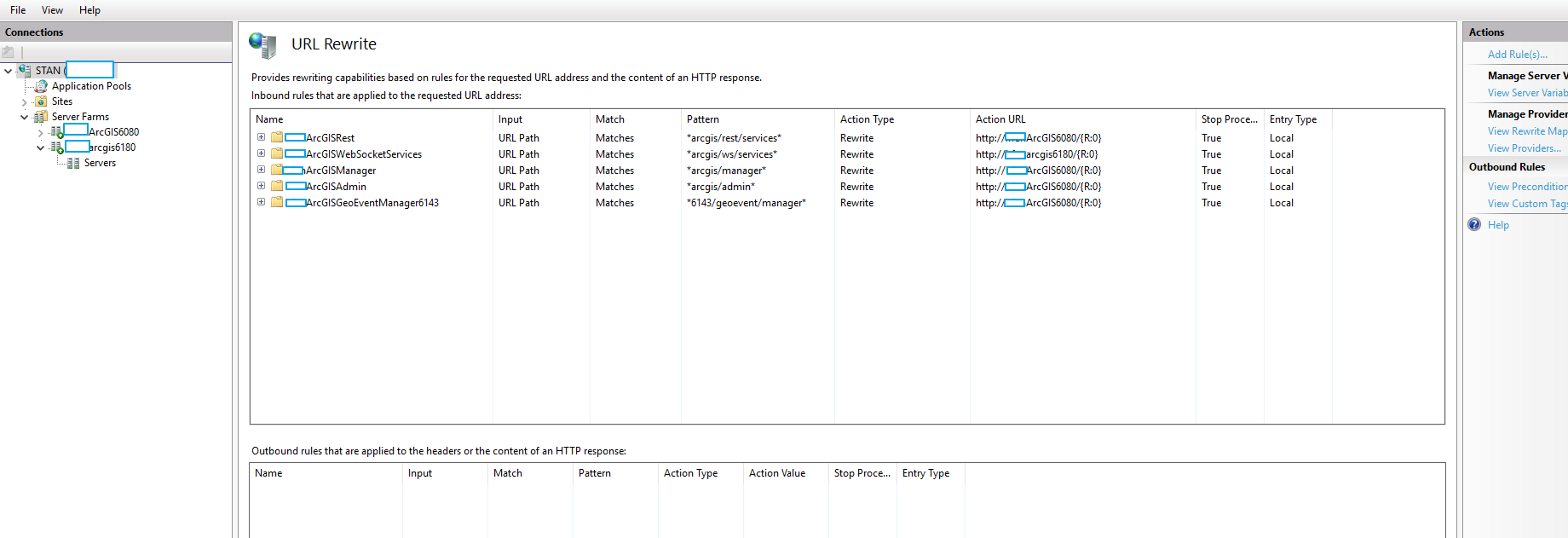

3) Setup in IIS: See this screen cap: Pretty much sums up! Although I think the Rewrite rules could be improved?
4) On the ArcGIS Server VM, go to: http://localhost:6080/arcgis/admin/system/properties and enter: {"WebSocketContextURL": "ws://dev.myfqdn.com:6180"} . Note, the because in step #1 above, per the screen cap, there is a Server Farm entry for port 6180 this works.
