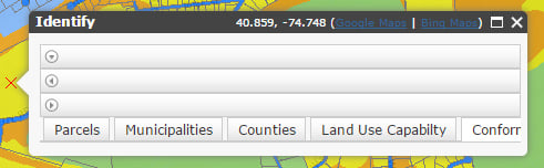

I am trying to programatically create a TabContainer in an InfoWindow and populate it with ContentPane's based on an identify task. The first issue I am having is the TabContainer is not embedding the slider and Menu correctly- they span the enitre top portion of the TabContainer. The second issue is the first contentPane is not showing its content, only the tab. If i click on another contentpane the content is displayed.
Do i need to resize the tabcontainer?
the portion of my code:
