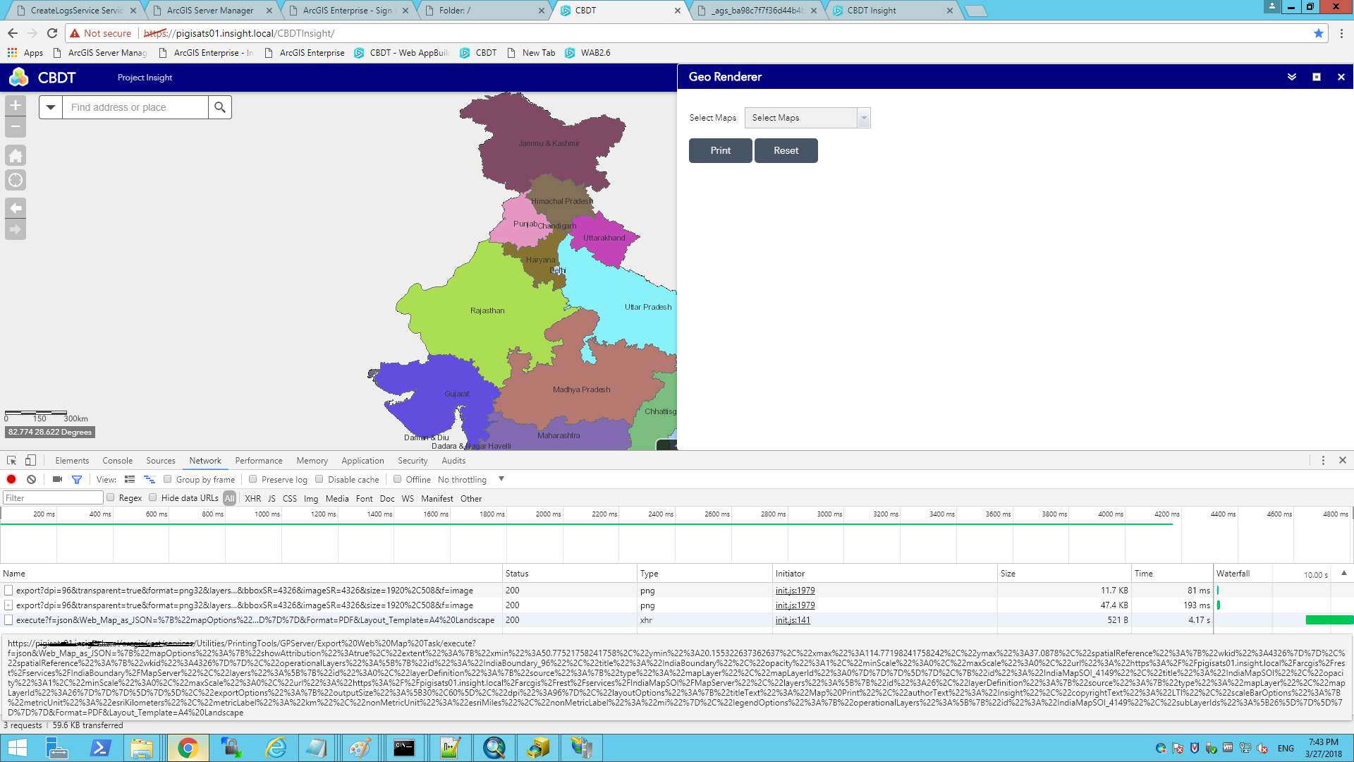

The above code works fine in for WAB 2.5 using ArcGIS JavaScript API 3.21 with dynamic Map service Layer as a basemap. Please find below image for the same without any error any console window

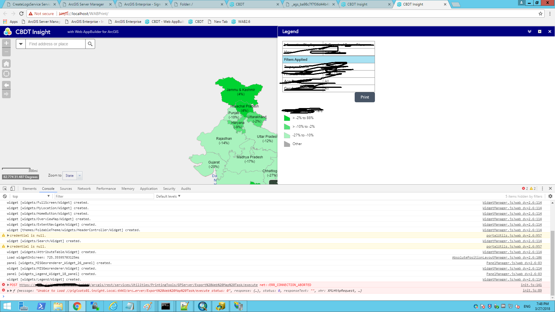

Whereas same code, with WAB 2.6 using ArcGIS JavaScript API 3.22 with tiled map service as a basemap is not working.Please find image below

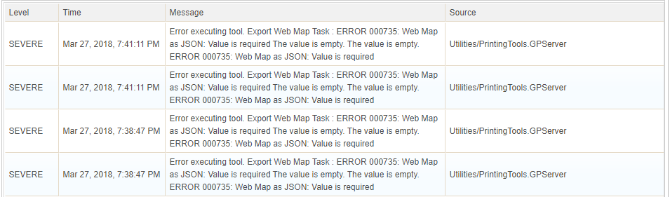

I found that the request for WAB 2.5 serves GET request, whereas WAB 2.6 serves POST request by default. Also when i check server manager logs it s saying "error 000735: web map as JSON:Value is required". Please find below image-
How to resolve this issue??
