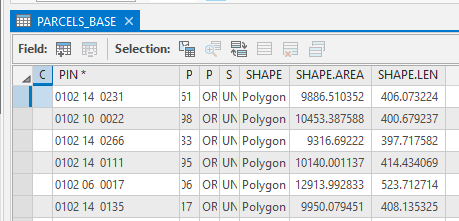

First, the attribute table, with PIN being the field where I'm trying to filter the results:

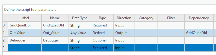

Next, the parameters (ignore debugger)
