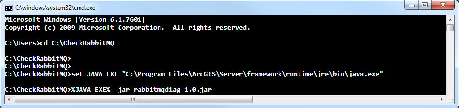

Please download and unzip the attached CheckRabbitMQ.zip to a local folder on the server on which you have installed ArcGIS Server and the GeoEvent Extension. Open a Windows command shell and change directory to the folder containing the files you extracted from the ZIP archive.
In your Windows command shell, execute the commands illustrated below:

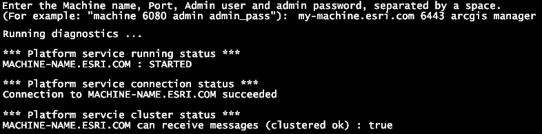

- Enter the Machine name, Port, Admin user and admin password, separated by a space.
- (For example: “machine 6080 admin admin_pass):
I tend to specify a fully qualified server name and domain (e.g. machine_name.esri.com) - and because my ArcGIS Server is configured to allow HTTPS connections - I specify port 6443. You could also specify localhost and port 6080 if your ArcGIS Server is only configured for HTTP connections.
If the utility is able to retrieve a status from the RabbitMQ platform service, connect, and receive a test message, you should see messages like the ones illustrated below:
