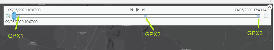

I have enabled time on each of the layers and playing around with the slider I can make the points appear over time. The problem is that as there are 2 days between each cycle ride so the total time extent of the slider is 5 days as shown below. I highlight the 3 time periods on the slider.
As you can see most of the time slider is "nothing", i.e. no data for those time periods between the 3 featureclasses.
My question is: how do you make one time animation occur immediately after the other, without waiting for 2 days to pass before the next featureclass begins to show up on the map? Is this even possible? I essentially want to skip over the time gaps and play each animation immediately after the previous.
