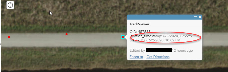

For example, we can see in some point features the two date values are quite close (here they are only 2 mins apart):

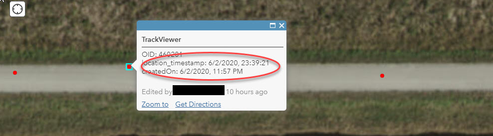

In other instances the two dates are hours apart:
I'm asking because we are processing tracks at the top of each hour by querying the location_timestamp values from the last known location_timestamp value we maintain. However, if the point features were added at a much later time then they'll be missed if recent tracks have already been processed. That is, we don't look back in time for points added after the top of each hour.
I'm pretty sure I'm assessing this correctly but hoped to get some confirmation so that I can implement something to process the missed features.
