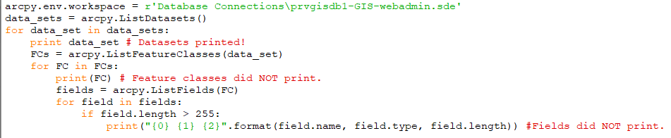

Here is the code I have so far.
It does begin with import arcpy - I forgot to include that in the screenshot.
Here it is in a form where you can copy and paste if you want to try it out with your own workspace:

It successfully connects to the database and prints the names of the datasets (this printing is for testing purposes). However, nothing else printed.
I know the last half of the code does work, though - I have successfully gotten the long fields to print when I told it which feature class to look at. And there are indeed fields over 255 characters, so something should print.
Apparently there is some problem in this code where I have tried to put all the pieces together.
Any suggestions?
