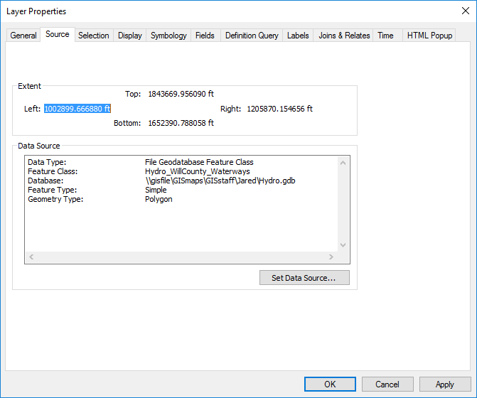

1.) The source \\gisfile\GISmaps\GISstaff\Jared\Hydro.gdb, as seen in the screenshot, is what I want to replace.
As a stand-alone script, this does not change anything in the Map. However, it runs with no errors and both print statements print what they're supposed to.

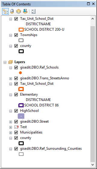

2.) Same thing in IDLE Python 2.7.13. It runs with no errors and both print statements print. But, nothing happens in the map.
3.) If I run the same script in the ArcMap Python pane it will work.
