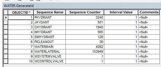

I am at a water utility and we cover multiple cities. I would like to generate ID's for our fire hydrants. Our ID's start with the first letter of the city then a sequential number after it. ie P1200 or C1564. Problem is we have a different number of hydrants in each city and the sequential numbers are at different values (see attached). I do have a layer that I can add that has polygons around the cities with a field that has the first letter to be used for the start of the hydrant number.
My question is, can I have multiple sequences for one layer? If so how can I tell the assistant to use a particular sequence? I would be fine if it prompted me. So if I am adding a new hydrant in the city of Providence, I would like it to use sequence PHYDRANT so the next hydrant number would be P3240. If city of Johnston use sequence JHYDRANT and next Hydrant number would be J0501 and so on. Also hydrant numbers are 4 characters long, but I think I know how to accomplish that.
