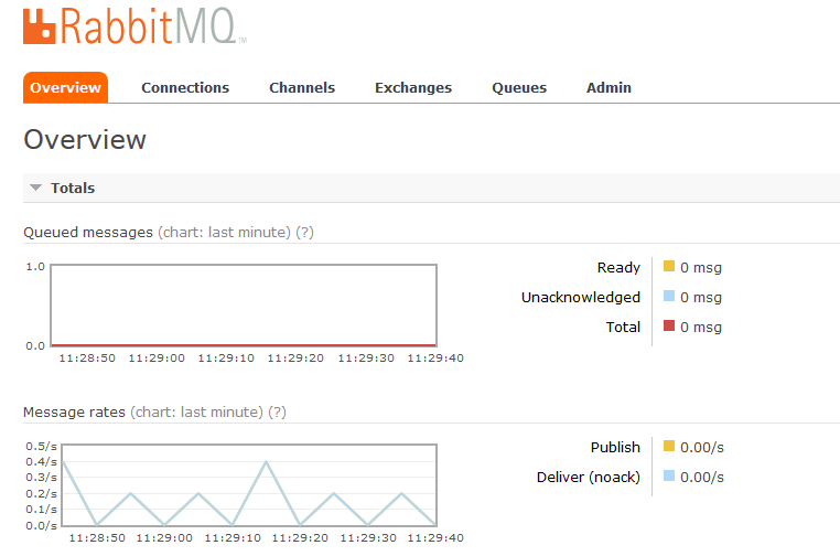

Now the interesting thing is that although I can't access the console the processes are all functioning correctly and I can logon to RabbitMQ and can see that activity is occurring. We also receive the output as emails from GEX regularly.

I would like to know if I can use RabbitMQ to export the configuration so that I can uninstall and re-install GEX and SP1 to see if the error resolves on the server.
