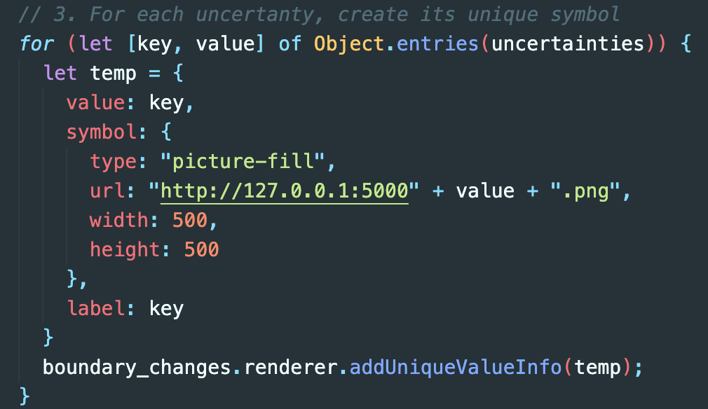

Thus, I do something like the following, where the variable boundary_changes is a featureLayer already added to my map with a unique-value renderer who's uniqueValueInfos is initialized as [ ].

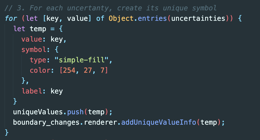

Sadly though, ArcGis does not query my server for the images and all of the polygons are left without any fill. However, when I do the exact same thing with a simple-fill symbol (shown below) and give everything one color, it works fine.
So my question is this: can anybody tell me at what point an ArcGis PictureFillSymbol actually requests the image from the URL field? How should I update the renderer to properly load the images from their respective URLs?
I have tried calling the function refresh() on my feature layer after adding all the unique values hoping it would trigger the renderer to grab the images, but this still does not work.
