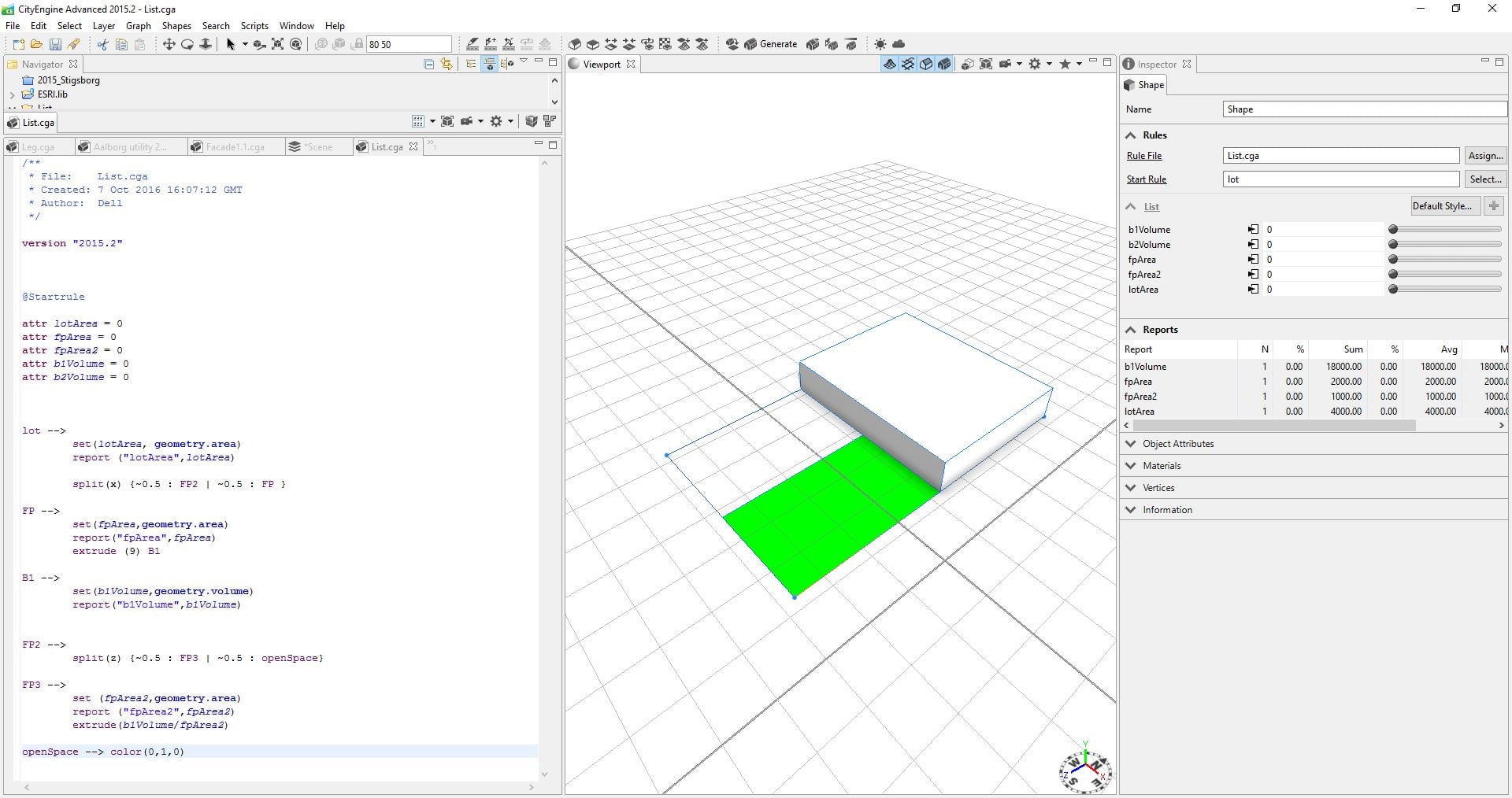

I have encourtered some problems when writing cga rule files, one of them is that I want to split a shape in two, and then extrude number 1 and split number two into two new "shapes". one part of the secound split will then be extruded so it allways has the same volume as extrusion one, see picture.
But this i have not been able to do as fare as i understand it it is becouse it calculates volume one in one branche of the tree and then it is not able to use the data in another branch, is this something you would use python to or what?
I now that for this particular exmaple there is some matematiks that can solve the problem, i think what i'm looking for is a way to store some data in an attribute and then use it again but in another branch of the tree.
