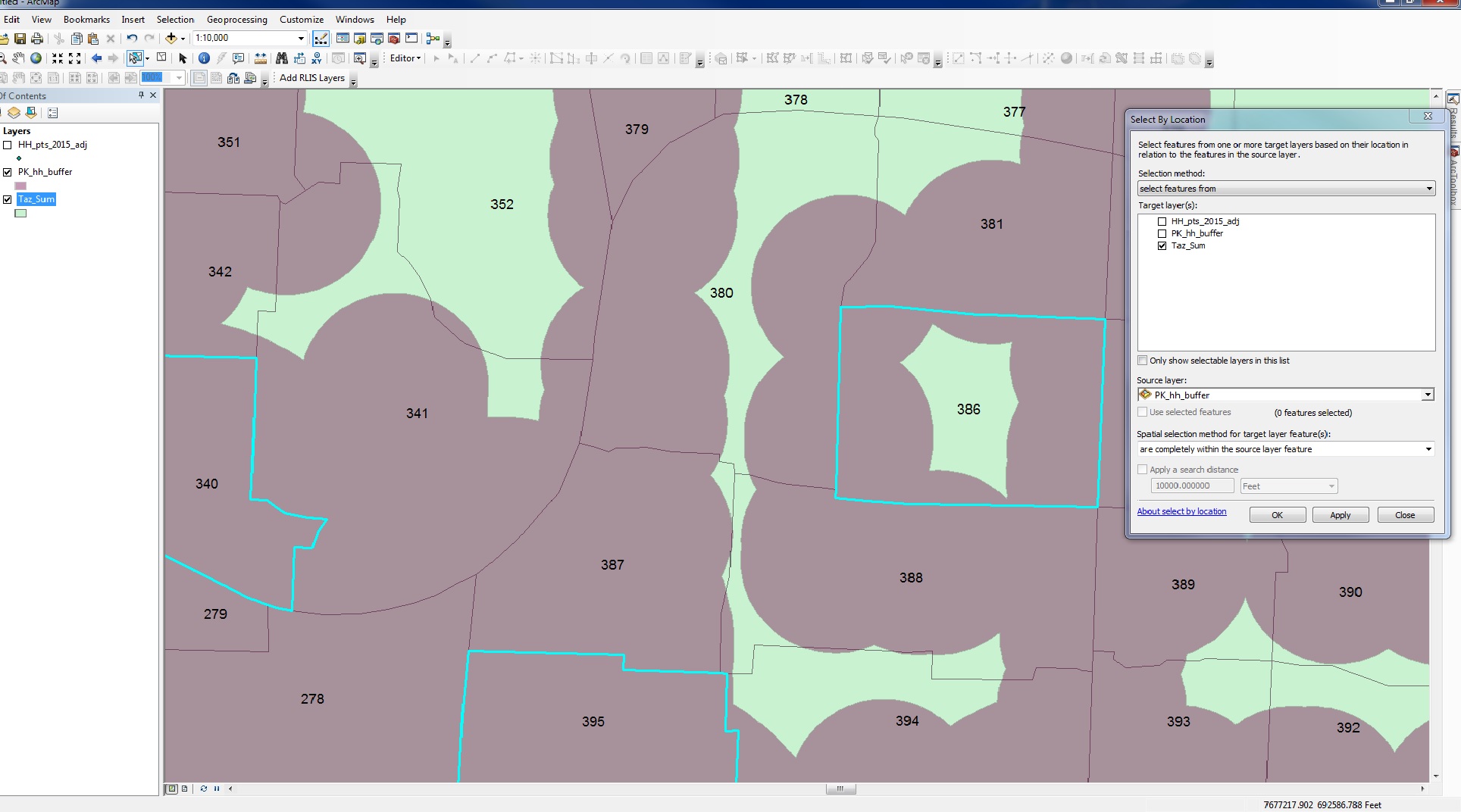

I’m trying to select TAZ zones (Green) that are completely within the Buffer Area (Purple) but I’m having some troubles with the selection. I’m currently using the select by location tool with the completely within the source layer feature for the special selection method, however it seems that it selects zones that its contour are covered regardless of the entire area. For example if you look at zone 386, id say is covered by about 50% yet is selected under the criteria and zone 387 is not. Is there a way I can create a selection query that would take into account the entire area of the taz and not only the contour?
Im using ArcGis 10.1
