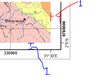

For many years I have been suffering how to display both GCS & PCS at ArcGIS Layout
Above Image show Both GCS & PCS at one corner of my Map,However there is error of Cartographic grammar in Geology Map ,(indicated a gap of number 1 ) in Geology Map there no need a gap at Neatline,due to the next adjacent Geology map, It should fixed in neat line at Layout
I fixed a gap by tightly a map with Neatline(margin line) .Ever look next image below whats happen
Labelled no 2 , GCS corner coordinate jumped/shift to other part of Map
Labelled no. 3 , cause to apply graphic or manual coordinate to place missing labelled GCS
Indicator line no 4, show a place missing GCS at its position to be .
However PCS looks okay
.....I am worry may be a ArcGIS Layout neatline is rectangular not curved as natural Latitude & Longtitudal line is curved in nature... graticule line..

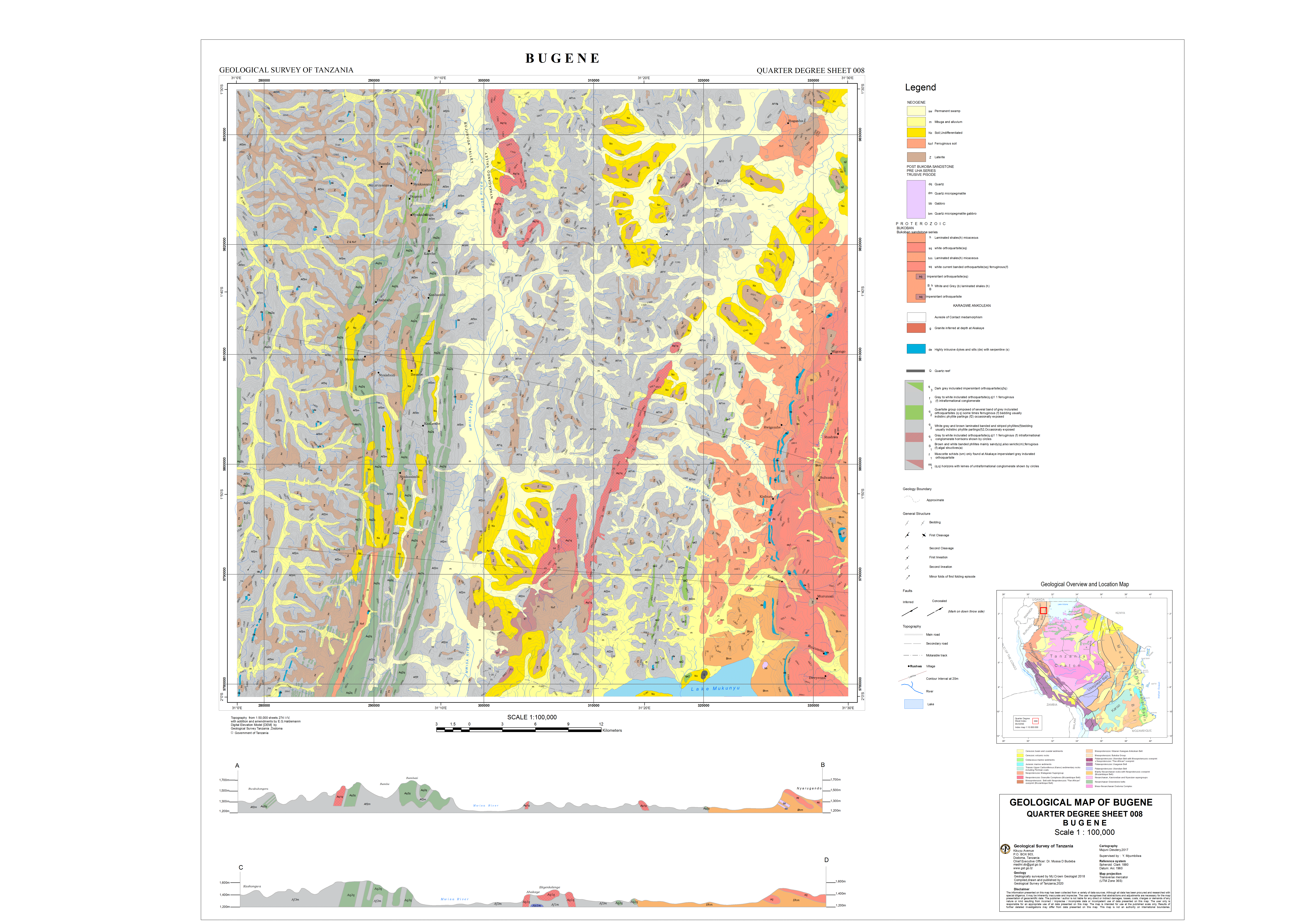

Please refer whole Geological Map and its 4 Corner point where problem occur
1st Corner Point before displayement of GCS occur but a gap to neatline appeared and its not needed in Geological map to allow adjacent next geology map to join & futhermore Geocoding Raster
Otherwise you can refer link for Vector data & its Mxd layout map ,http://www.arcgis.com/home/item.html?id=ab3406f7563d4b5cbae13c88fd098009
