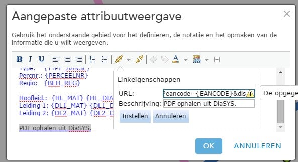

You can define an URL, based on a on attribute, in ArcGIS Online. This is a realy nice feature to create a simple interface to external web-based sources.
When using this webmap in the collector app this works fine on Android 4.4. When pushing the link, it automaticly was opening a browser (Chrome for example), and showing the right webpage.
But 2 weeks ago this stops working. What is happening now, is that collector tries to open the resulting URL inside the Collector app, in the attribute window.
