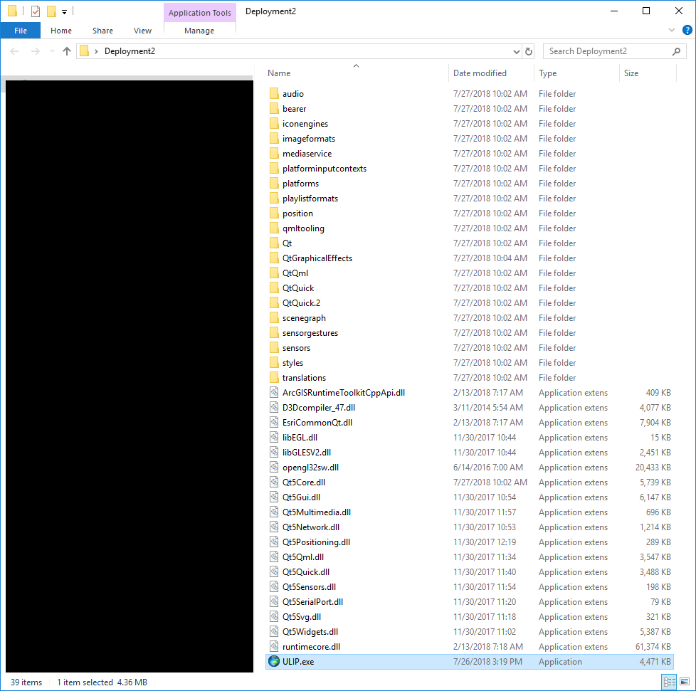

4. Copy the sdk runtime .dlls to the deployment folder:
Here are the contents of my deployment folder:
5. I run the app, and it works correctly. However, when I move the deployment2 folder to the tablet it executes, but nothing is rendered:
