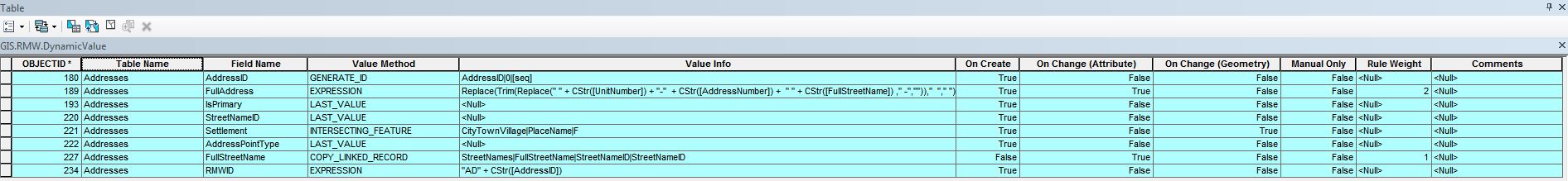

Last week I upgraded my computer to ArcGIS 10.4.1 and downloaded the latest Attribute Assistant release from the ESRI site.
We've had the attribute assistant configured for about 3.5 years so that if a streetname id for an address point is entered or changed the FullStreetname field would populate using the Copy Linked Record and our Streetnames table,and at the same time that change event (streetnameid) would also trigger the concantenation of the Full Address.
Now I've noticed since I've upgraded that if I change the Streetname ID for a record, the FullStreetname changes but now the Full Address does not change. It also seems to use the streetnameid from the last value array. However, if I manually run the Change Rules the Full Address concantenates using the updated FullStreetname.
I've tried altering the rule weights but it doesn't seem to affect it. Below is a screenshot of our DynamicValue table as it relates to our Address points.
Just wondering if something has changed in the latest release?
