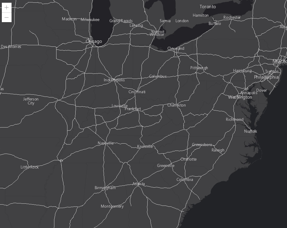

When I apply an arcade expression to the value expression property of my unique value renderer, it doesn't seem to work as expected.
Here is a jsbin example using a modifyed sample that esri provides:
JS Bin - Collaborative JavaScript Debugging
Here is the line in question:
valueExpression: "When($feature.type == 'Gravel', 'test')",
I would expect this to filter the layer down and only show 7 features, just like when the filter is applied in the rest endpoint.
But instead, all of the features in the map adopt the uvr symbol:
