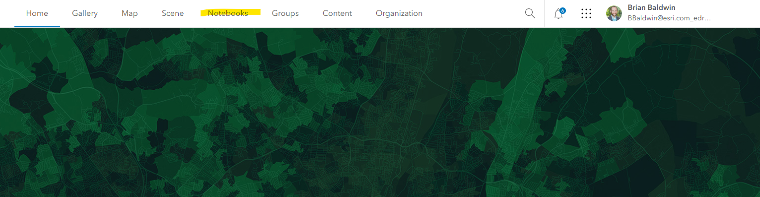

The workflow that I really enjoy, is creating and saving these scripts in the ArcGIS Online Notebook environment. Right within ArcGIS Online, you have a fully featured Python Notebook environment, you just need to open it up!
