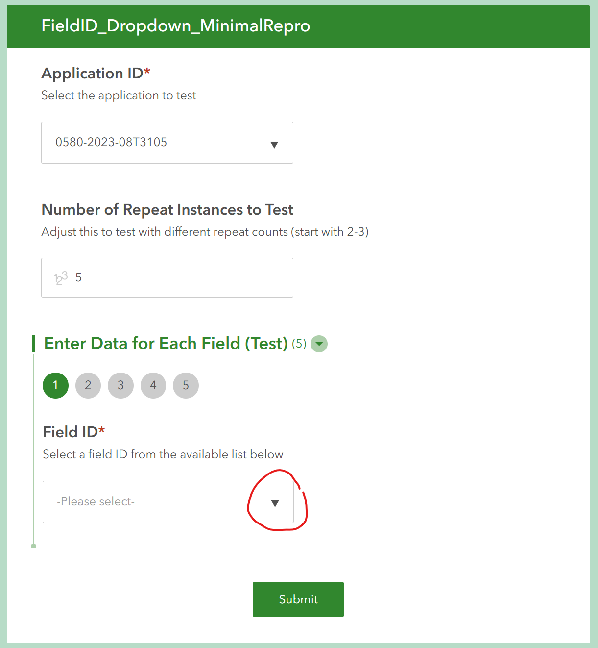

- A top-level select_one question (ApplicationID) using search() against a hosted feature layer.
- An editable integer question (NumberOfFieldsInApplication, default 5) controlling repeat count.
- A repeat (FieldData) driven by repeat_count: ${NumberOfFieldsInApplication}, containing a single select_one question (FieldID) using search() with a matches filter referencing the outside-repeat ${ApplicationID} value.

- Select a value for ApplicationID.
- In the repeat, select a value for FieldID on row 1 — this works correctly; a network request fires and the choice list loads.

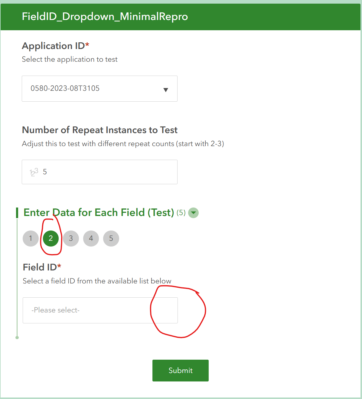

- Advance to row 2 and click into the FieldID dropdown.
Expected result: The same search() query fires (filtered by the same ${ApplicationID} value) and the choice list loads, identical to row 1.
Actual result: Nothing happens. No network request is visible in the browser console (confirmed via DevTools → Network tab — row 1 shows a fetch request to the feature layer's /query endpoint; row 2+ shows nothing at all when the dropdown is clicked). The dropdown remains empty/unresponsive indefinitely.
