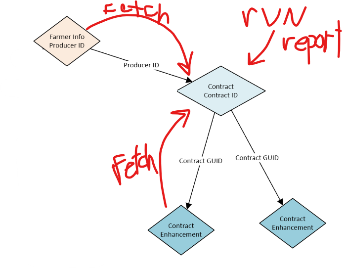

I want to add a few attributes from a parent table in my survey123 report, that was not available in the survey. Right now Survey123 Report Templates (& ExB Report Widget Templates) are limited to the $feature records and it's "children". There is no way to query a "level up" or parent related table.
Example:
Farmer submits a "contract" request via survey123 and adds some relevant repeat information in a related table to that contract... cool. After that, the contract is assigned a Producer ID based on another table in the layer. This table has a producer ID key with a 1:M relationship with the "Contract" request table. This "Farmer Info" table contains information like their name address, etc. One producer ID can have multiple contracts etc. The Farmer Info table is just not submitted using survey123, but it's in the feature layer and it has relationship classes. This is public survey and we can't expose the Farmer Info table to let them add their own repeat contracts to their existing producer ID. We do it later, assigning the key after.
Then I want to create a report about that specific contract and it's related records, but that table doesn't have that basic information in it, like name and address... so I want to report that additional parent information... but just for that 1 contract that I selected from my table. $layers doesn't work because Farmer Info is a parent table, not a child, and not using survey123 to run the report. #RelatedName doesn't work either because it's not a child and wasn't ran using the survey123 report. The report generator doesn't seem to have a way to fetch parent attributes.

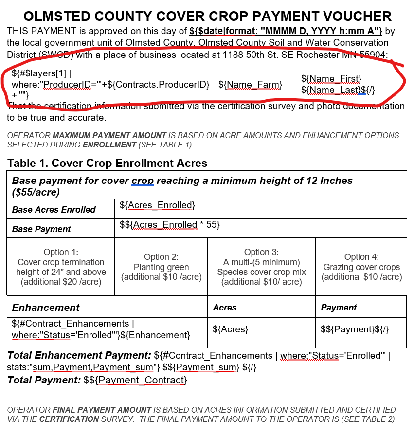

It returns errors like this. The feature service url seems to populate correctly, but the return is undefined.
An error occurred when assembling data. Error message: Cannot read properties of undefined (reading 'name'). The expression leads to this error: ${# $layers[1] | where:"ProducerID='222’"}. The query request: https://services.arcgis.com/t...tzwI/arcgis/rest/services/Grou...w/FeatureServer/1/query?f=json&where=%28ProducerID%3D%27222%27%29+AND+%281%3D1%29&outStatistics=%5B%5D&groupByFieldsForStatistics=&having=&orderByFields=&resultRecordCount=&returnDistinctValues=false&outFields=*&token=anB....
