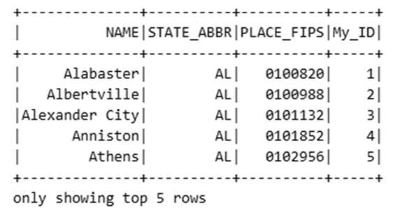

myFSDataFrame.show(5)
Using the resulting DataFrame as our sample dataset, we’ll write that to our ArcGIS Online account so that we have a new feature service that we can edit.

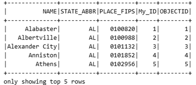

myNewFSDataFrame.show(5)
Our new feature service has all of our original fields, plus a new OBJECTID field that was automatically created when we write the feature service.

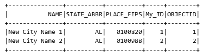

Now let’s see what happens when we want to update a subset of our data. To keep things simple, we’ll just update the records with the first two IDs – in other words, we’re going to replace “Alabaster” with “New City 1” and “Albertville” with “New City 2”:
# edit two rows to update
updated_row = myFSDataFrame.filter("My_ID in (1, 2)")\
.withColumn("NAME", F.when(F.col("My_ID") == 1, "New City Name 1").otherwise("New City Name 2"))
updated_row.show()
If we want to update our feature service on ArcGIS Online with these new records – but only update these two rows of data – we can use upsert to do that. Let’s write this DataFrame with two updated rows back into our feature service. When we write this data back, we set the mode to “append” and we’ll specify our upsertMatchingField as “My_ID.” This will match the unique IDs for those records and swap out the attributes for just those rows.

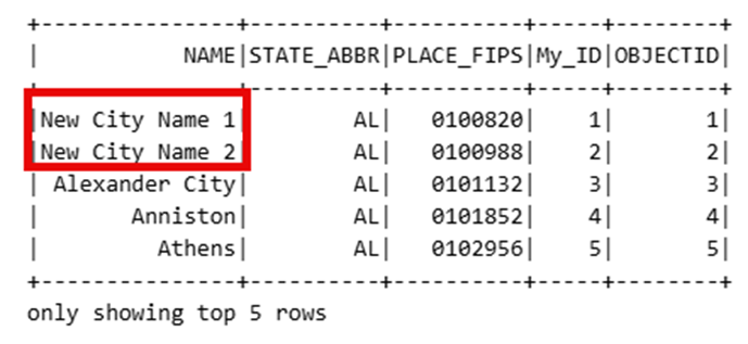

myFSDataFrame_after_upsert.show(5)
And only two rows needed to be updated! This will typically be more efficient than overwriting the whole table.
