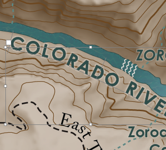

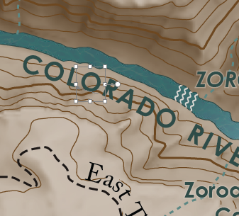

When I export labels for a curved line feature, for instance a river, road, or trail, from Pro to .aix, they export as individual characters, each as it's own layer.
Often I need to change the label placement of these features and to do so I have to delete the existing label/characters and replace with a text along path element (or move each individual character--um, no).
I would like the ability to export these labels as text along a path so I can edit in Illustrator if needed:
