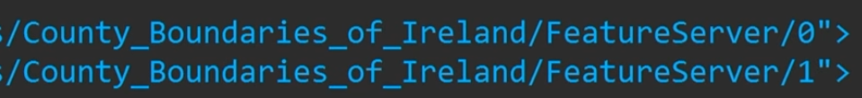

You can check to see if the new feature layer can be found in the FeatureLayerCollection (or Item) object layers property. (Comment out the insert_layer() snippet and re-run)
print(*flc.layers, sep="\n")
print(*item.layers, sep="\n")
You will see that two FeatureLayer objects are returned.

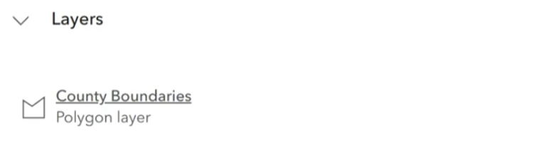

However, if you pay the feature service a visit in ArcGIS Online, this second feature layer is nowhere to be seen. Let's fix that!

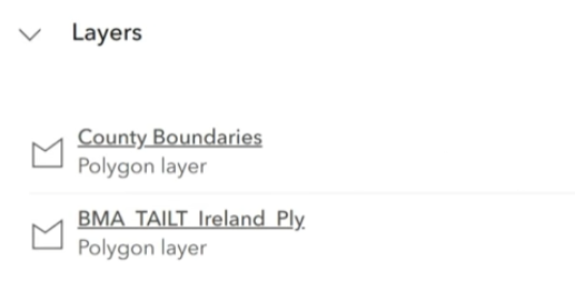

The lyr_dict represents what was printed to screen for a layer definition from item.get_data(). The id gets populated based on the id from the newly inserted feature layer. The layerDefinition is populated with the symbology, and we have the popup enabled and with one popup element for the fields. The fieldInfos need to be populated so we grab all fields from the feature layer and make them visible in the popup.
Next, the layers key from the returned JSON Data is updated to add in the new definition, and finally the Item object JSON Data is updated to commit the change.
Now, when we visit the feature service Overview, Data, or Visualization table, the newly inserted feature layer is present.
