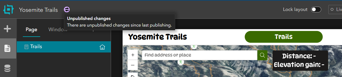

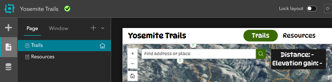

Here's an example of a published app. This app had two pages: Trails and Resources.
I deleted the Resources page and "accidently" hit Save. Now my app state has Unpublished changes.
Here’s how to revert the changes saved in the draft, to bring it back in sync with the published app:

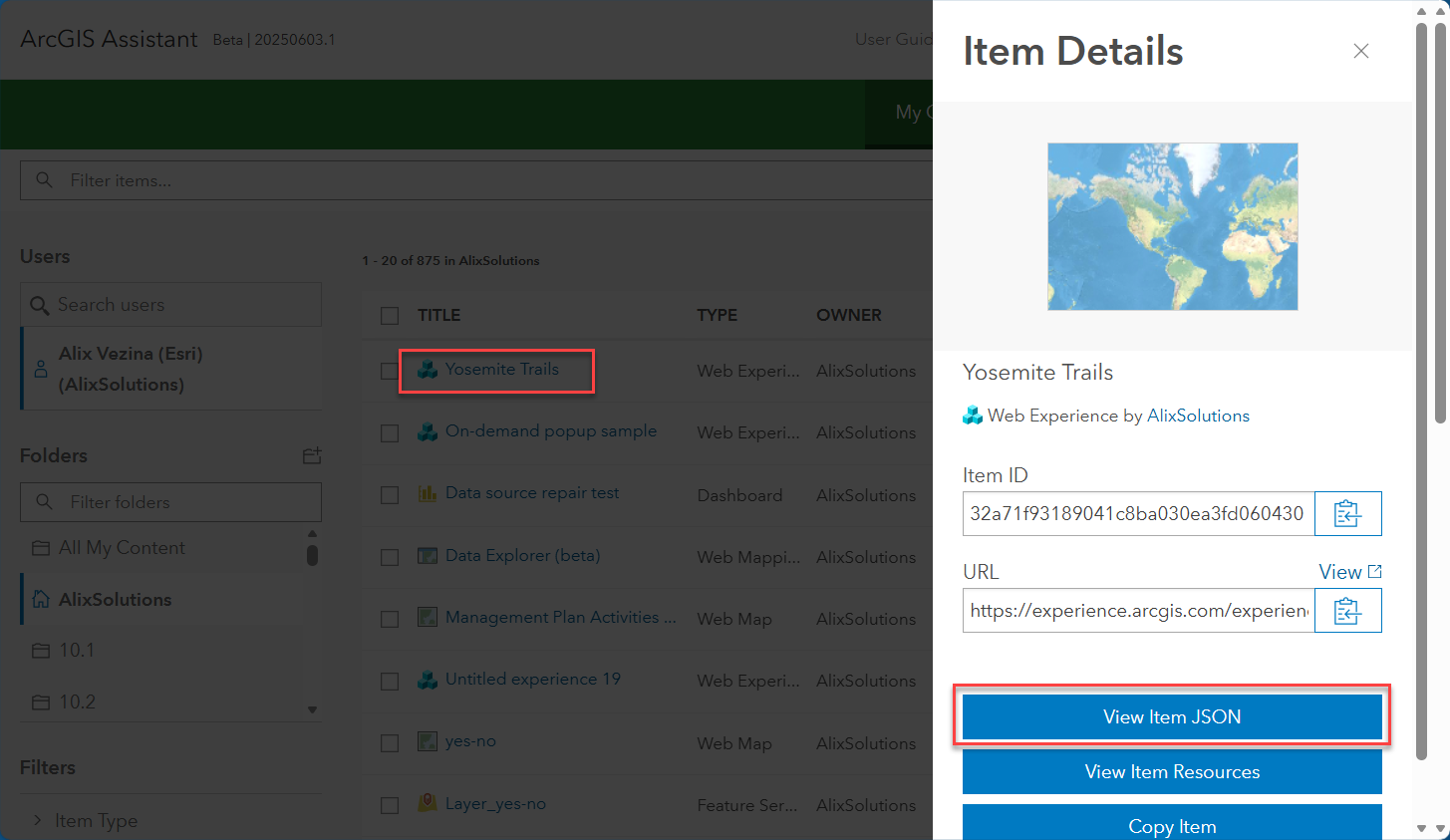

- Go to the ArcGIS Assistant
- Sign in to your account with ArcGIS Online or ArcGIS Enterprise, where your app resides
- Find your app in your Content
- Click the item to open the details, and click View item JSON

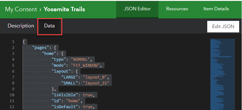

- Click the Data tab, then select and copy all the code (note: this is the code from the published app state)
- Go to Resources and open the config/config.json file (note: this is the code from the draft app state)
- Click Edit Resources
- Select all the code and paste the code you copied in step 6
- Click Save

- Go back to your app builder, hit refresh, and verify that your app changes have been reverted
