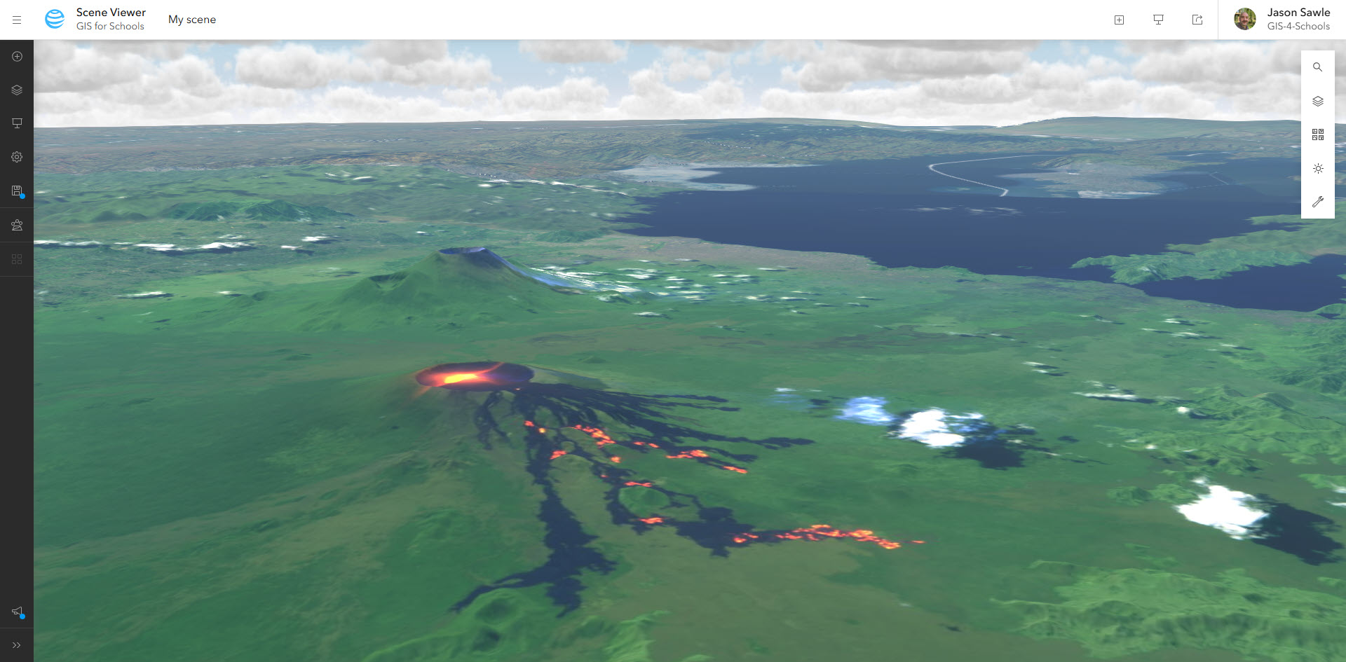

Once the image is saved as its own layer you can share it with students through a WebMap, in a StoryMap, explore it in 3D (see below) or even as part of a VR experience using the 360VR app.
