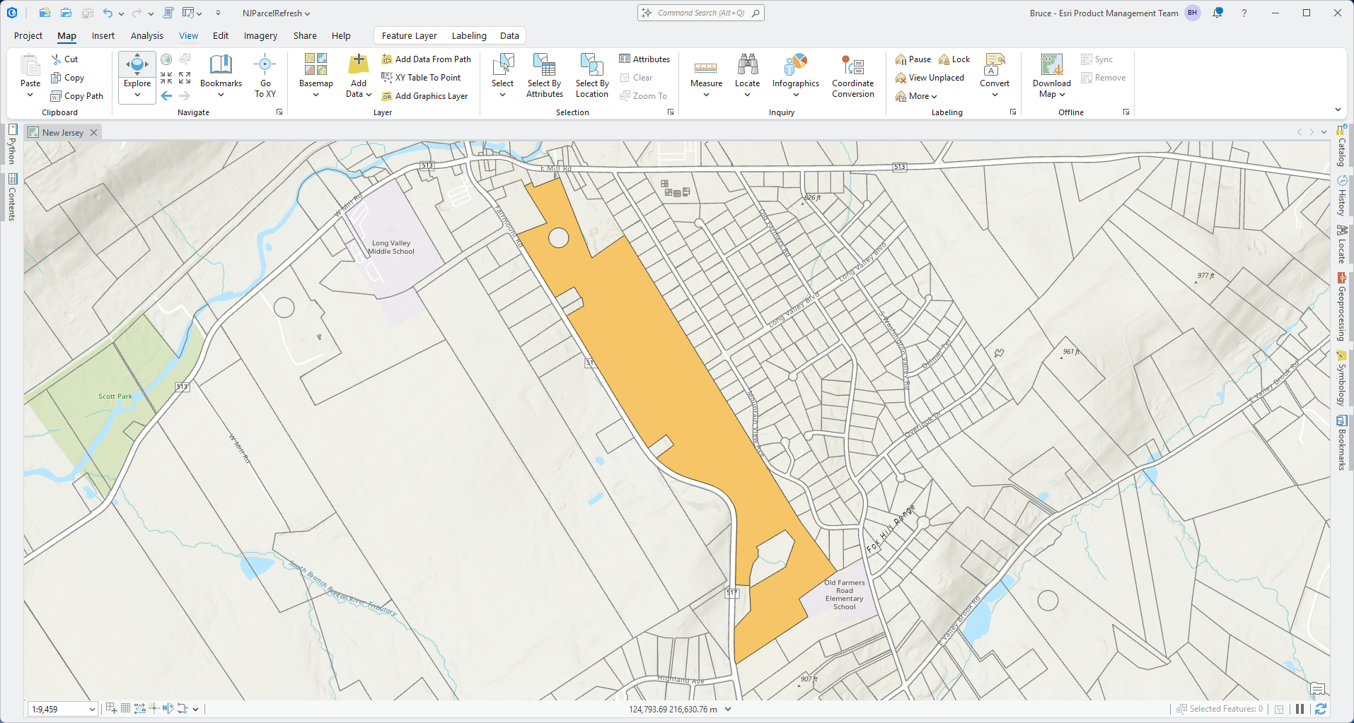

Here is my subject matter data, the State of New Jersey's parcel data (~3.5 million features, 4.4 GB with 45 fields), with thanks to the NJ tech team for their assistance putting this sample together.
I'll get to why one parcel is highlighted shortly...

This where the highlighted parcel in the map comes in. Parcels may have complex geometry, boundaries may have multiple segments, and segments may be true curves. While storing true curves in hosted feature layers is supported, editing them is constrained. See here some relevant properties of my target feature service:

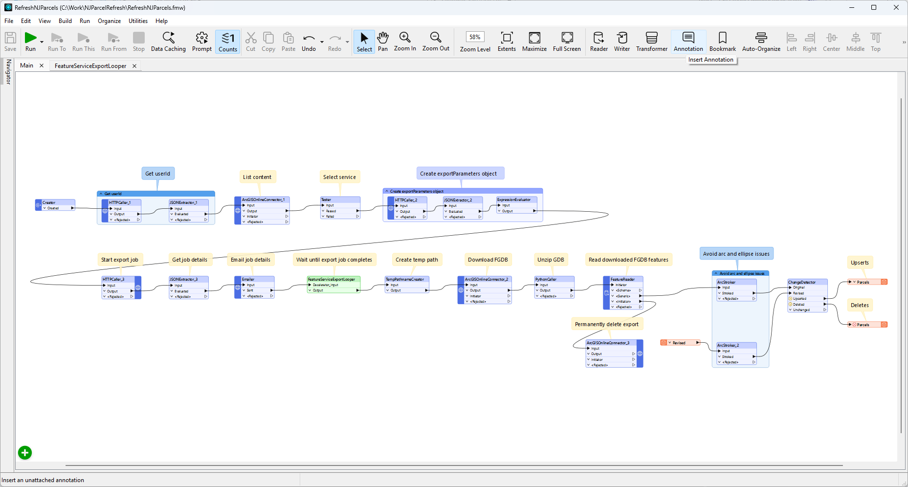

A simple way to manage true curves is to stroke them into polylines when doing geometry comparisons or when writing them to the feature service by using the ArcStroker transformer, with control over maximum deviation from the true curve. This replaces any arc segments with polylines, temporarily for geometry comparison and permanently for any parcel written that has been updated or is new.
Here are a couple of views of the workspace that does the whole job, first the Main view...

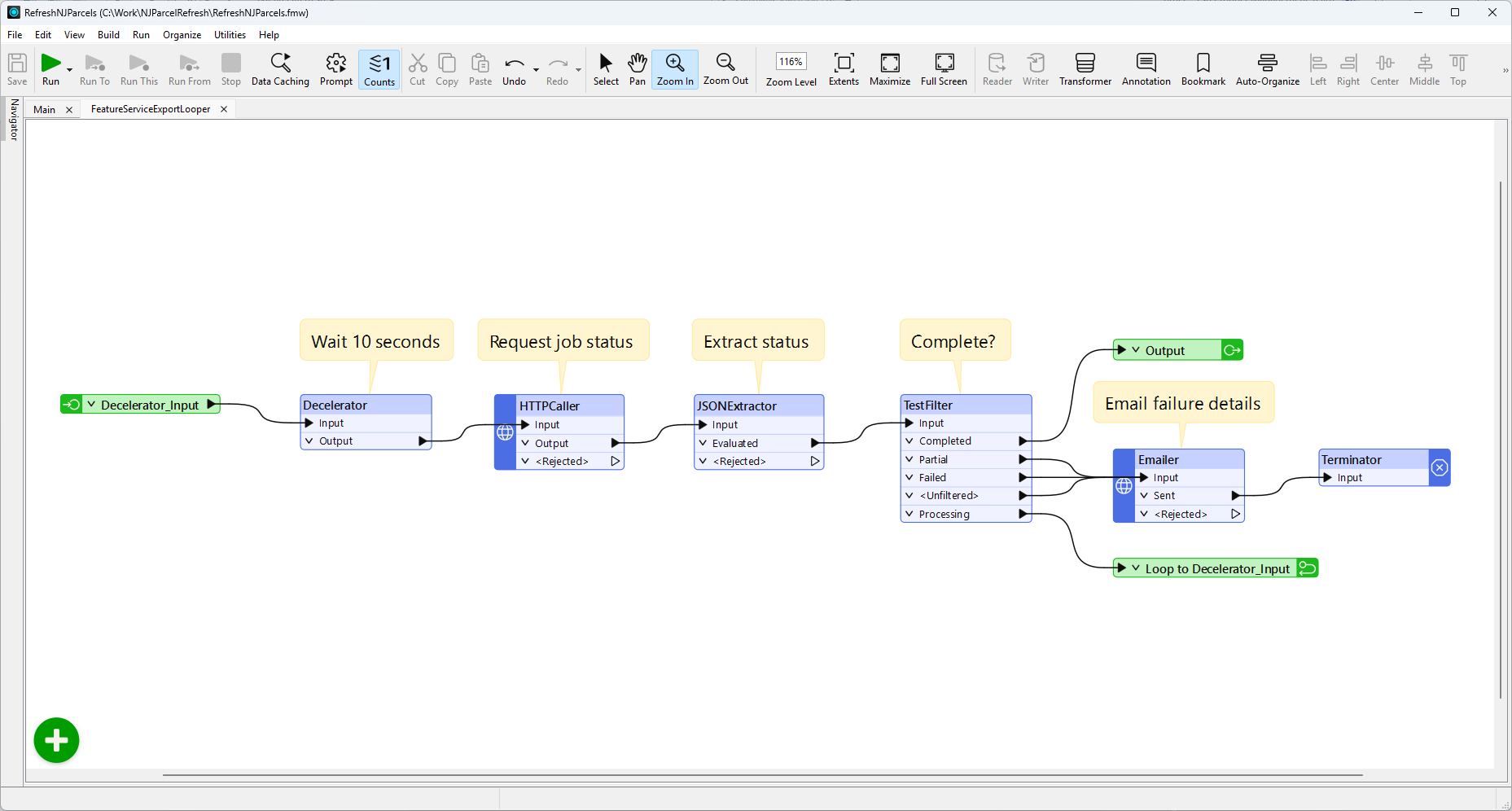

...then the pale green looping custom transformer that waits for a file geodatabase export to complete...
The file geodatabase export takes a variable length of time, depending on how busy ArcGIS Online is. I ran the tool at a scheduled time that worked out to 3AM UTC, it took 23 minutes for the export. I have seen 10 minutes, or an hour, but I have also seen failures when testing at busy times for ArcGIS Online. Scheduling the tool to run outside busy times in North America and Europe is recommended, so I used 3AM UTC.
To apply "defensive coding", just ahead of, and again inside the looping transformer which waits for export job completion, there are a couple of Emailer transformers that send job submission details and job failure details if that occurs. Esri support will need both job and failure information to troubleshoot your service behavior on error, please do open a support call if you experience any problems.
