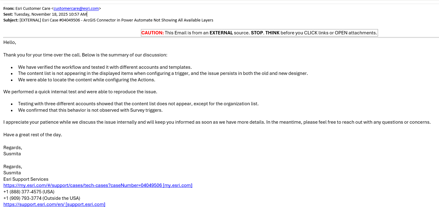

UPDATE 11/18
For anyone who comes across this post and is experiencing the same issue, ESRI was able to replicate the issue and they are looking into it.
Update 11/20
ESRI created a bug ticket for this issue, but based on @AkshayHarshe response below there may or may not be a bug. Just an opportunity to improve ArcGIS Connectors where specifying search in "My Content" or "My Organization" is not available to select such as the trigger and the connector "Fetch Updates, Changes, and Deletions". For now, the work around to use the feature layer REST service URL did work.
