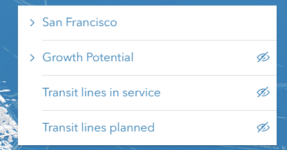

This is the out out-of-the-box layout of the layer-list-widget:

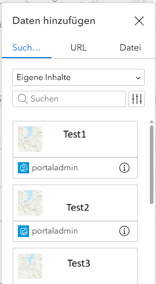

This is the out-of-the-box layout of the add-data-widget in ExpBuilder:
Adding new layers is simple but it is not possible out of the box to remove them from the local layer list.
Also the add data widget has its own list ob added data, unnecessary duplicate to the layerlist widget.
