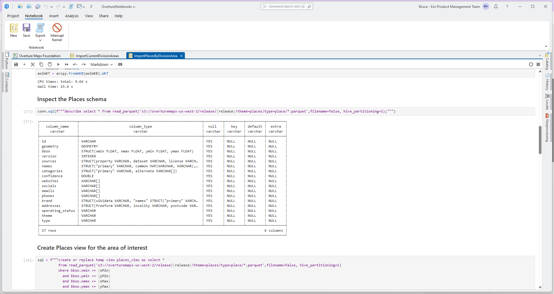

Overture data is available in GeoParquet format. You may have seen discussion on GeoParquet being a candidate to be the "new shapefile" - the de facto format for sharing georelational data. While GeoParquet isn't editable like shapefiles are (except by replacement) it has many attractive features, one being support for complex column types. See in the schema for the places theme:
Places theme schema as seen by DuckDB
Note that several columns are struct type, with the structs containing complex properties. The data isn't flat, and to get the most value from the data (division area translated names, place point alternate categories and address components etc.) you must unnest the structs. You'll see in the notebooks I don't unnest them all (because some were empty) but no useful data was left behind. So when working with parquet, be prepared for a higher information density than shapefiles.

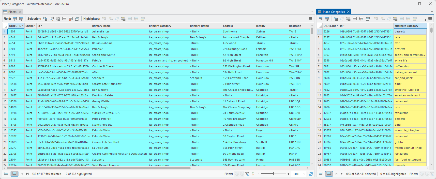

You'll see in the blog post notebooks that a couple of structs are unnested and relationship classes created to the resultant tables, like here where searching for ice cream shops in the places data lets you see what other categories the outlets identify as...
Ice cream shops also offering...

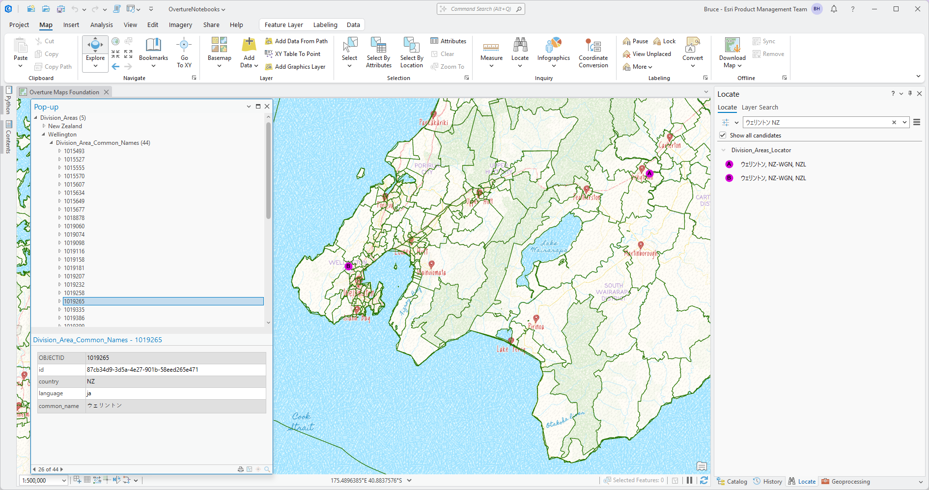

Many division area names have common names in other languages, see below we can identify the Japanese name for Wellington, New Zealand (ウェリントン) and use it in the division areas locator.
Geocoding from the Japanese name for Wellington, New Zealand

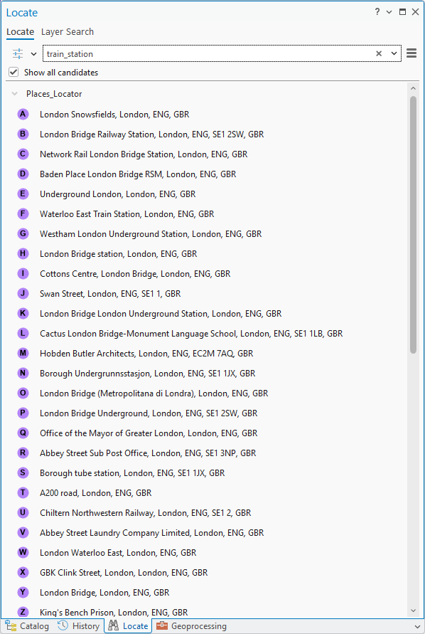

One of the higher value themes from Overture is places data, and the locator built from that data provides a compelling map navigation experience - using place category as a hint to refine a geocode.
For example hinting I want to find a train station:
Train Stations

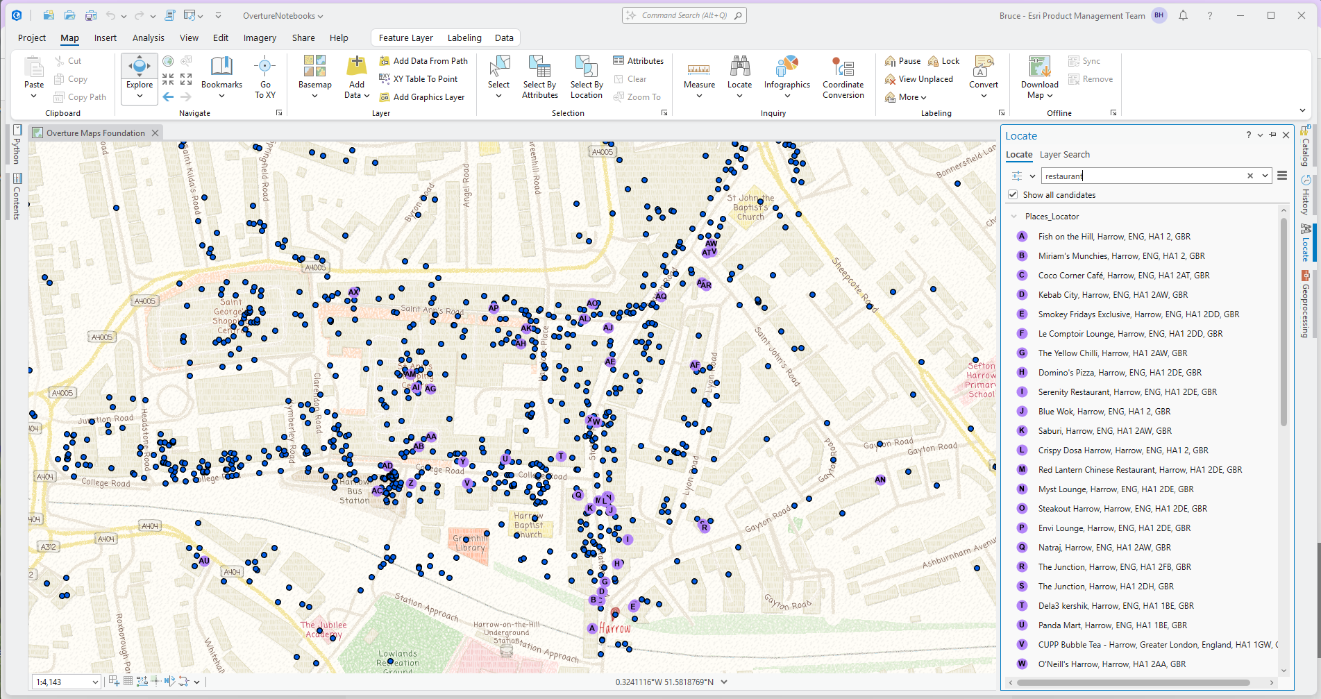

Or a restaurant in my map extent:
Restaurants

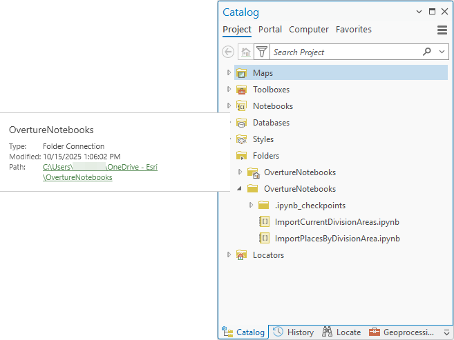

Sharing notebooks to OneDrive
The notebooks are suitable for external consumption. They automatically detect the changing input path at run time - so are good candidates for sharing to OneDrive, from where your colleagues may run them on demand - the "one click" experience. OK well maybe two clicks, open the notebook then run it 😉..
To share the notebooks, create a folder in OneDrive, copy the notebooks into it, then share the folder and notebook source files to anyone, with edit permission. People invited to the folder can use OneDrive's browser-based controls to add the folder to their local files, then from Windows Explorer drag the folder connection into an ArcGIS Pro project folder connection.
Notebooks on OneDrive
