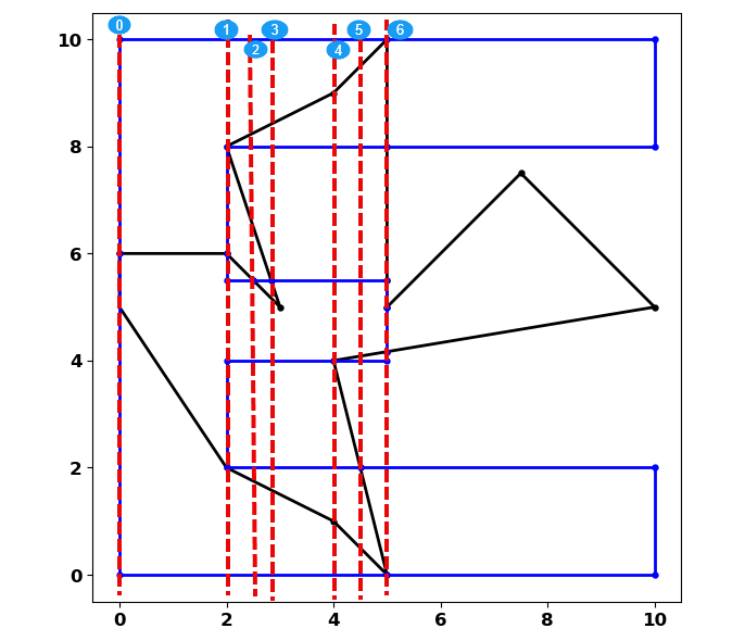

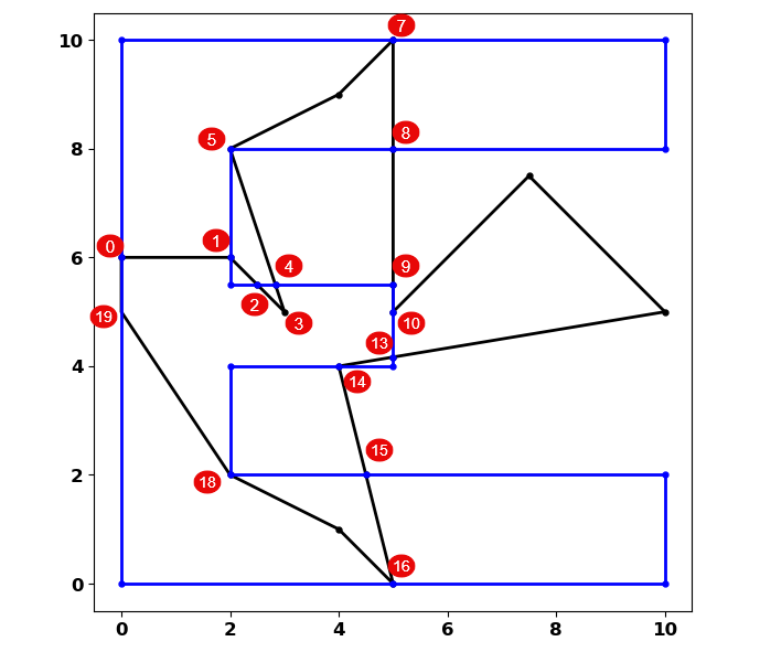

This forms the basis of "sweep-line" or "plane-sweep" algorithms.
In the figure to the right, there are 4 sweep lines which are identified where the two polygons share a common point. The common points are 0, 1, 2, 3).
Note that the original order differs from the lexicographic order since point id 3 is encounted before number 2.
