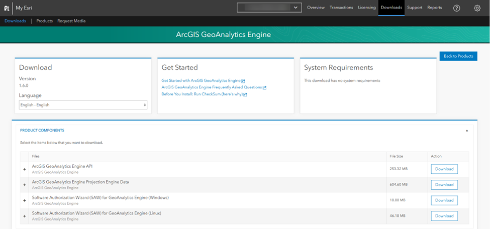

You can download the files for GeoAnalytics Engine from the My Esri account associated with your GeoAnalytics Engine subscription. The Esri account associated with your subscription will be listed in the email that you receive.

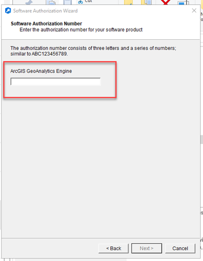

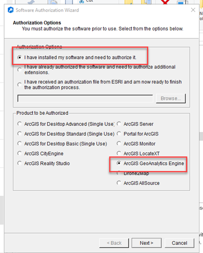

You will need to generate a license file using the Esri Software Authorization Wizard; the ECP license string will be used as input. This license file will be used for authentication with GeoAnalytics Engine Disconnected.
You can access the Software Authorization Wizard from the My Esri portal where you find your GeoAnalytics Engine files.
For generating the license file, you will just go through the prompts using the Software Authorization Wizard.

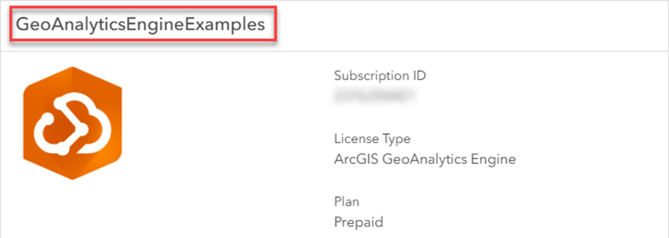

- Provide an Organization Name. This is the name that will appear on your GeoAnalytics Engine dashboard. As an example, the organization shown below is named “GeoAnalyticsEngineExamples”

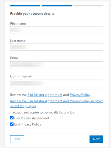

- Provide account details and accept the master agreement and privacy policy terms. This is where you can set the name and email for the administrator of your account.
Account name. At this point in time, the name associated with the account cannot easily be updated, so we recommend selecting a generic name, e.g. “MyOrg GeoAnalytics Admin.”
Account email. When your GeoAnalytics Engine account is set up, it is tied to a single email address for the administrator. You cannot change this via the GeoAnalytics Engine dashboard user interface.
To future-proof, we recommend using an email alias internal to your organization (e.g., geoanalytics_admin@yourOrganization.com) instead of a single user’s personal email address. By doing this, the alias can be managed and re-directed internally by your organization if the GeoAnalytics Engine administrator departs, changes roles and is no longer administering your GeoAnalytics Engine license, or you no longer have access to the emails sent to their individual user email.
