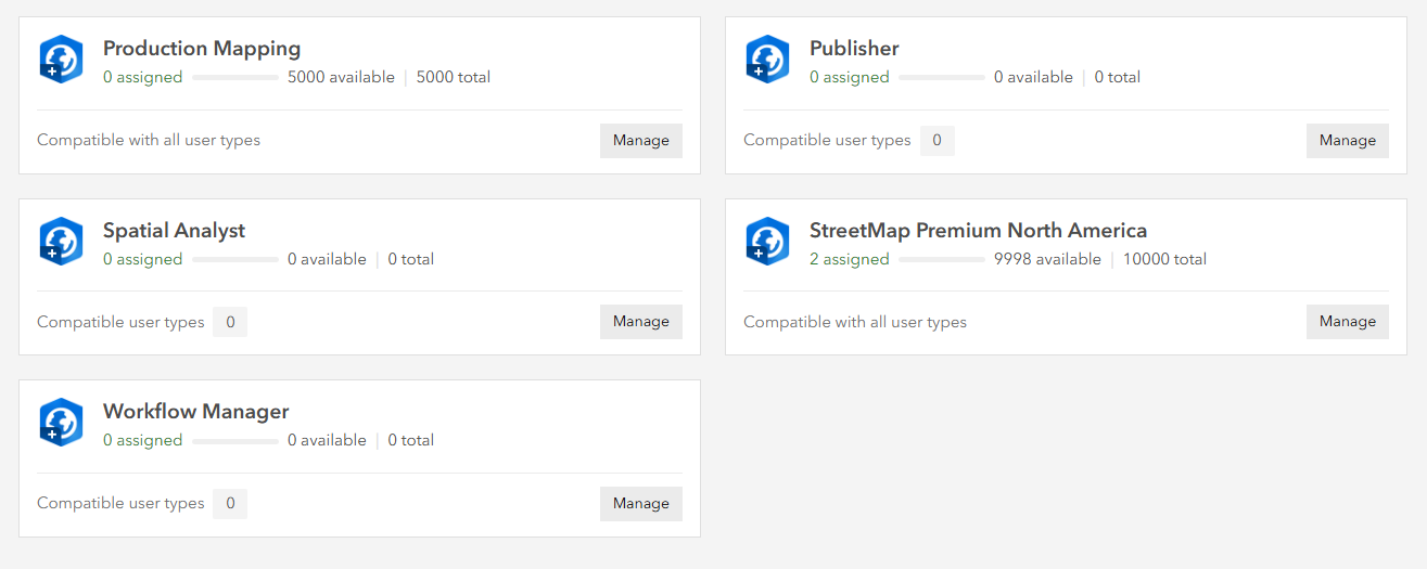

Why do I already see thousands of licenses for StreetMap Premium?
For any college or university with an Esri Institution Agreement (not Departmental Agreement), it might be confusing to discover that you already have StreetMap Premium ArcGIS Pro extensions. But this does not mean you have StreetMap Premium. If you have 5,000 Professional Plus users, you should see 5,000 StreetMap Premium North America licenses as well. The reason for this is that a ‘light’ version of StreetMap Premium is included as part of the ArcGIS Pro Business Analyst extension. The goal is to enable ‘local’ (within ArcGIS Pro) Business Analyst functionality that will not consume credits for users related to network analysis and geocoding.
This ‘light’ license of StreetMap Premium does not include the StreetMap Premium locators or datasets, so they will not be visible as downloads within MyEsri. This license is to be used solely with the ArcGIS Pro Business Analyst extension.

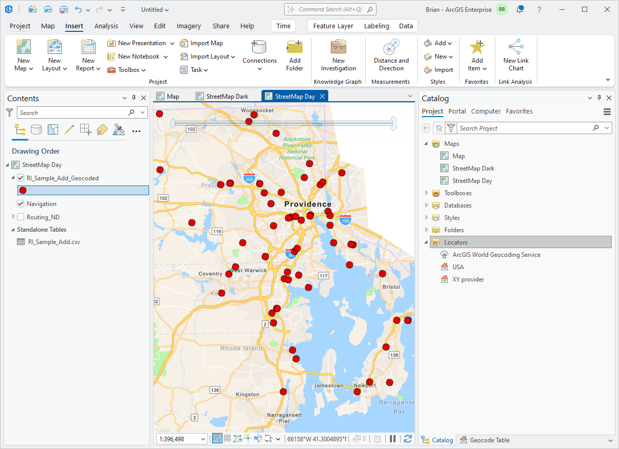

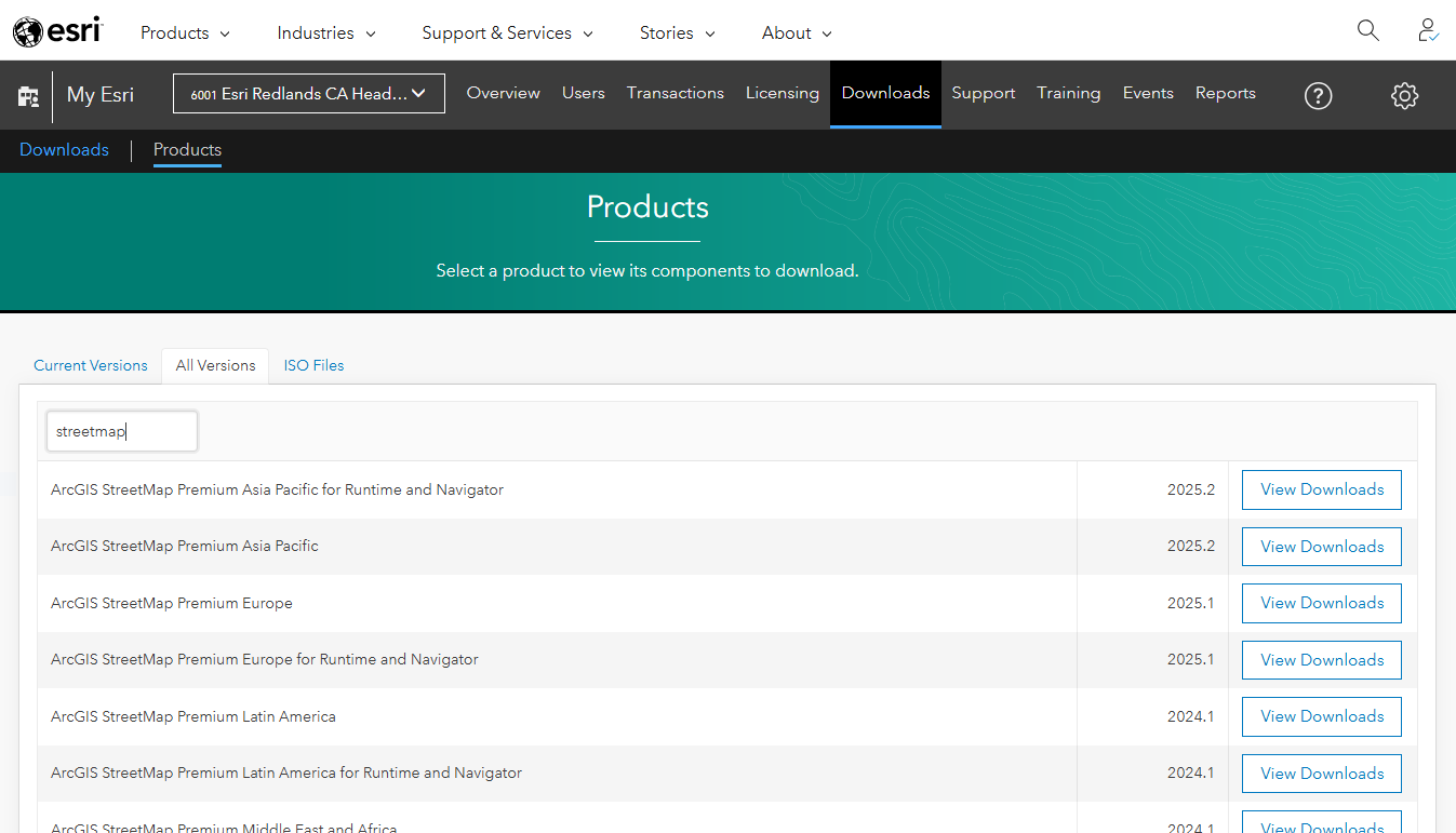

From within MyEsri, an administrator can then download the latest StreetMap Premium data as a Mobile Map Package (MMPK). This MMPK contains maps and locators. Users can open and use the MMPK within their own project or use the locator files when they are unpacked.
Now, a user just needs to ensure that they select the correct locator when they conduct their geocoding (in this case, USA, NOT the World Geocoding Service).

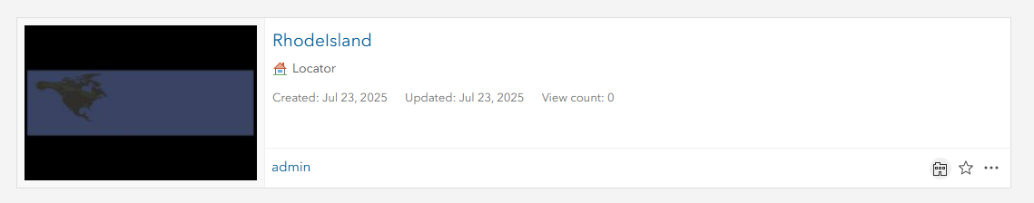

To publish a locator service, a user needs to have the StreetMap Premium Pro Extension enabled and load the MMPK of interest. They can then right-click on the locator and publish it as a service to the Enterprise instance.
The locator will then be visible as an item in ArcGIS Enterprise and can be shared with users just like any other item.
Users will not require a StreetMap Premium license to utilize this locator and they can access it in ArcGIS Pro or via the web.
