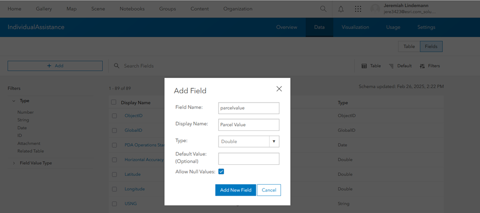

- Click +Add.
- Add a field name of parcelvalue of type Double.
Note if your parcel values contain special characters you may need to add of type String and may not be able to do further calculations. - Click Add New Field.

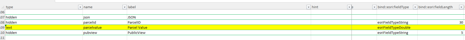

- In Excel spreadsheet scroll to row 109. Add the type, name, label and bind::esri:fieldType as below:

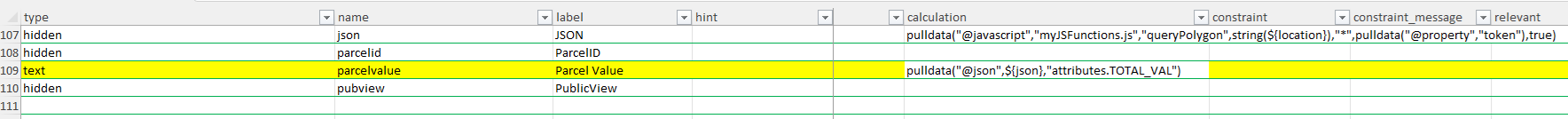

- Scroll over to the calculation column.
- . Add the following logic in the cell:
pulldata("@json",${json},"attributes.TOTAL_VAL") - Update the TOTAL_VAL value to the name of the field that represents your parcel identifier from the feature layer.

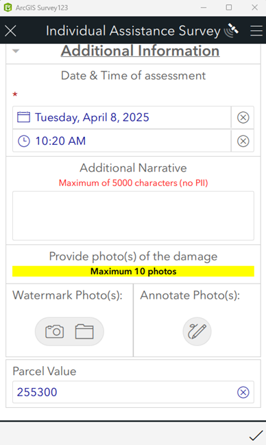

- Open Survey123 and verify at the bottom of the survey you see the values after you define a location.
Consider relocating the parcel value question within your survey, or alternatively, modifying its type to hidden so that it is not visible in the survey form. Additionally, you can add new fields perform calculations to perform damage loss estimates based upon the damage severity in the previous questions.
