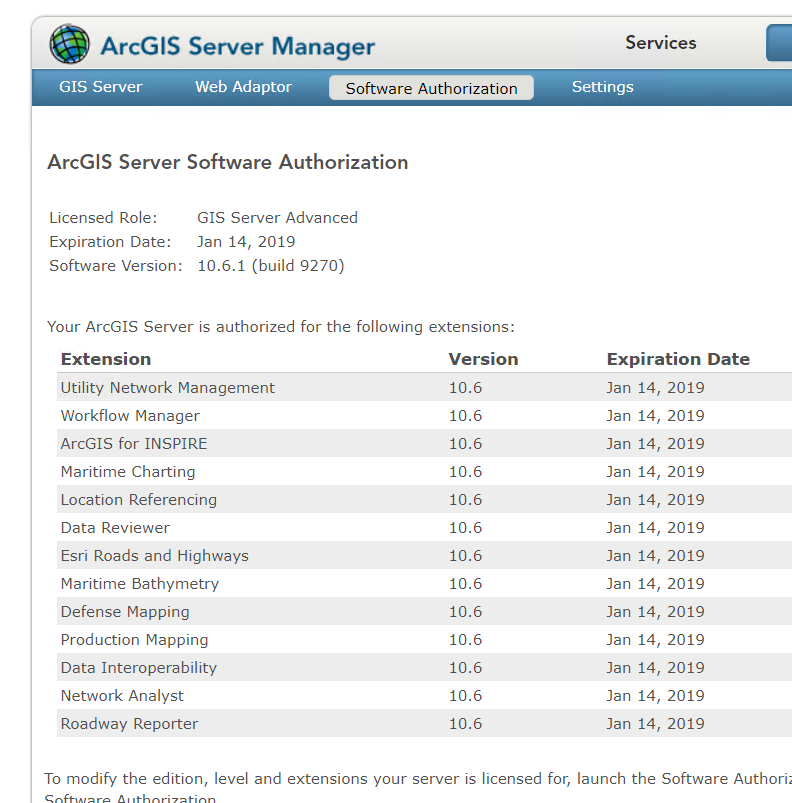

I am in the process of configuring Data Reviewer for Server to share a data QC review. The reviewer service is not starting and I am going to be walking through the information I have and maybe someone can help? In the below image, should the extensions say 10.6.1 and not 10.6? I did an in-place upgrade of the server from 10.6 to 10.6.1 and uninstalled all extensions before installing 10.6.1.

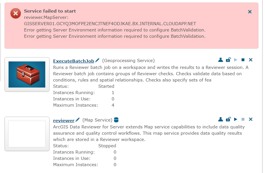

The DRS configuration utility completes, but the reviewer map service does not start. When attempting to start through the Server manager I receive the following error.

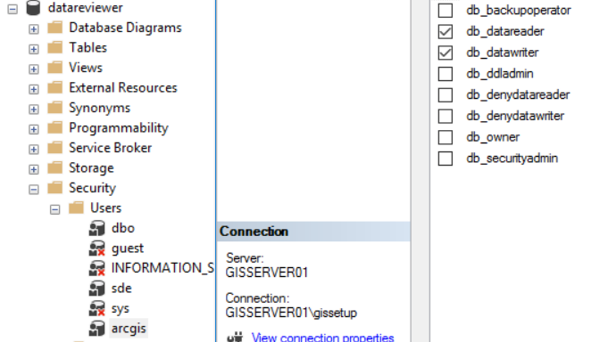

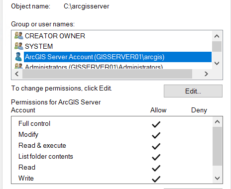

The Reviewer workspace exists in SQL Server on the same machine as the GIS Server. The folder containing the sde connection file does grant the GIS Server Account with read/write access.
I've even added the ArcGIS Server account to the SQL Database with data read and data write.
