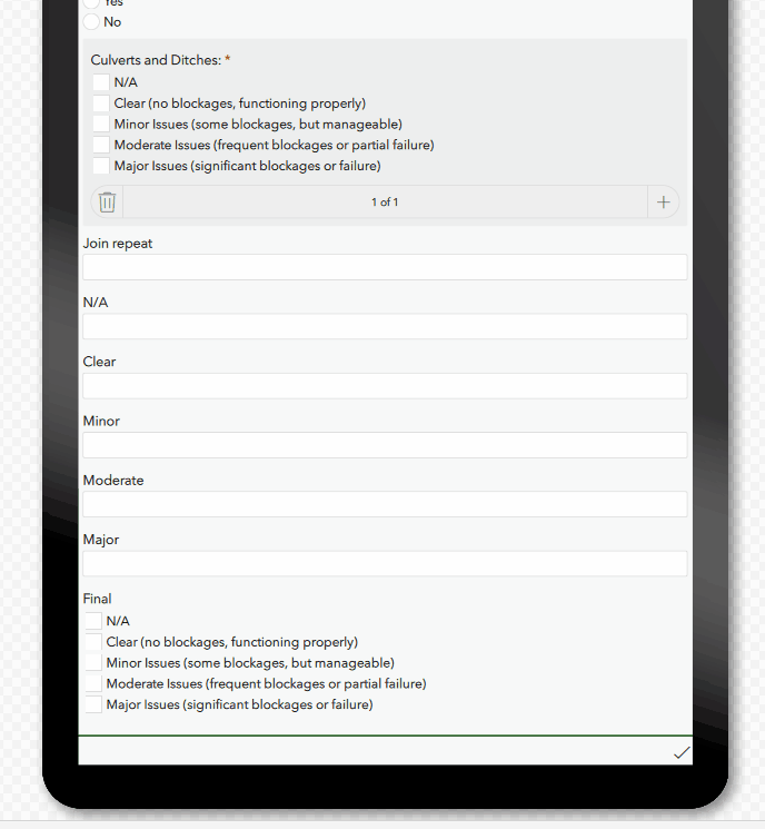

I was working on a form that needed to get a cumulative review of many questions in a repeat. For Single-choices, it was a pretty simple ranking of the answers using nested ifs.
| Name | Calculation |
| finculvcal | join("; ", ${culverts}) |
| finculv | if(count(${culverts})>0, if(contains(${finculvcal}, 'Major Issues (significant blockages or failure)'), 'Major Issues (significant blockages or failure)', if(contains(${finculvcal}, 'Moderate Issues (frequent blockages or partial failure)'), 'Moderate Issues (frequent blockages or partial failure)', if(contains(${finculvcal}, 'Minor Issues (some blockages, but manageable)'), 'Minor Issues (some blockages, but manageable)', if(contains(${finculvcal}, 'Clear (no blockages, functioning properly)'), 'Clear (no blockages, functioning properly)', if(contains(${finculvcal}, 'N/A'), 'N/A', ""))))), "") |
For multiselects, it's a lot more complicated:
| NAME | Calculation |
| calc | join("; ", ${culverts}) |
| finculv0 | if(not(contains(${calc}, "Clear")) and not(contains(${calc}, "Minor")) and not(contains(${calc}, "Moderate")) and not(contains(${calc}, "Major")) and contains(${calc}, "N/A"), "N/A", "") |
| finculv1 | if(contains(${calc}, "Clear"), "Clear,", "") |
| finculv2 | if(contains(${calc}, "Minor"), "Minor,", "") |
| finculv3 | if(contains(${calc}, "Moderate"), "Moderate,", "") |
| finculv4 | if(contains(${calc}, "Major"), "Major,", "") |
| finculv | concat(${finculv0},${finculv1}, ${finculv2}, ${finculv3}, ${finculv4}) |
(For the record, all of these except for finculv were calculations bound to Null; they do not actually appear to the user).
It would have been SO MUCH easier to just unique(${culvert}).
