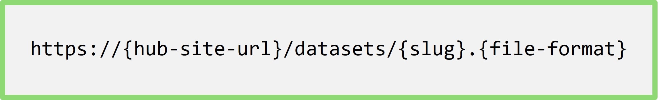

Legacy Downloads API format:
This previous version (Legacy Downloads API) could use a slug or an item id in the URL to achieve the same result. However, Hub is now using the Downloads API v1 endpoint, which requires the item id and does not support download URL's that contain slugs. Note that catalog feeds automatically use Downloads API v1.

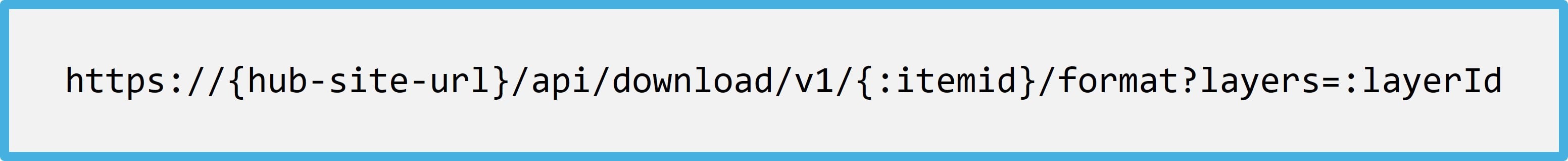

Downloads API v1 format:

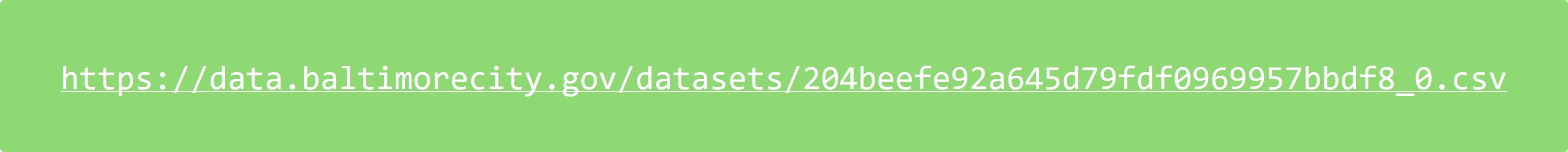

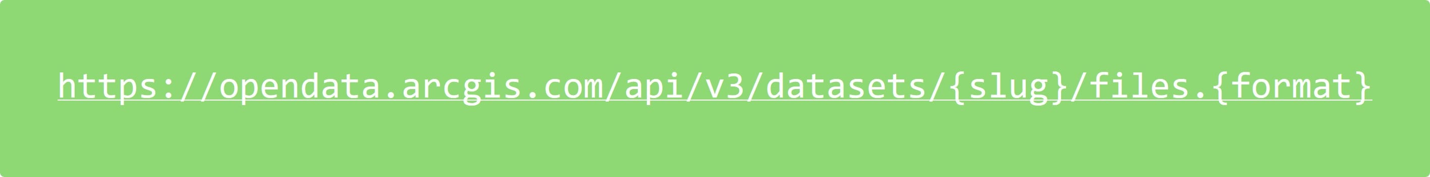

Legacy Downloads API formatted examples:

The (old) download URL with slugs will be redirected to Downloads API v1 such that up-to-date cache files are served. After a period of 90 days, you will not be able to use the slug with Downloads API v1 and you should use the item id. Downloads API v1 always requires item id, format, and layer id.
Downloads API v1 format (again):
