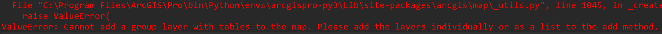

As of the ArcGIS API for Python version 2.4.0 and the introduction of the MapContent add() method, you can no longer add an item object that contains a Feature Layer and a Table. Below, I attempt to add a Feature Service to the Map that contains one Feature Layer and one Table.
"""Access the Feature Service"""
niah_fs_item = agol.content.get("WM_ITEM_ID") # NIAH
"""Attempt to add the Feature Service with a Feature Layer and Table"""
webmap.content.add(
item = niah_fs_item # this will fail!
)ValueError: Cannot add a group layer with tables to the map. Please add the layers individually or as a list to the add method.
2.3.0 did this just fine. Now I have to add Feature Layers and Tables separately.
