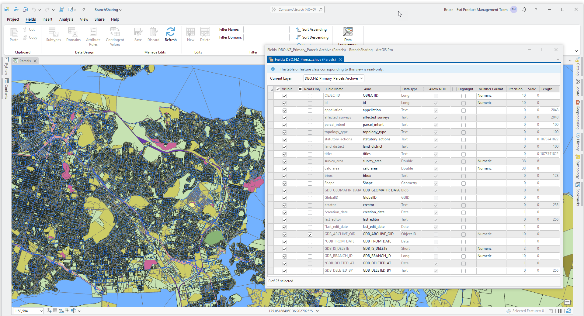

I did have to make GeoParquet files that I can query, and a maintenance workflow for initial and incremental parquet file creation . It all starts with the source branch versioned Enterprise geodatabase feature class. Normally you can't see the system fields that power branch versioning of a feature class, but if you add the archive class to the map they are available:
Archive class added to the mapArchive class added to the map
A couple of things to note in the fields map: ObjectID is demoted to an ordinary long integer (values are not unique any more) and various fields named GDB_* are added. They power viewing the data at a moment in time, which is how branch versioning works - the latest state for a feature wins, which may be a deleted state, but the data history isn't lost (unless you drop it), which makes time travel possible.
The archive class is also good for discovery of what edit moments are in your data.
