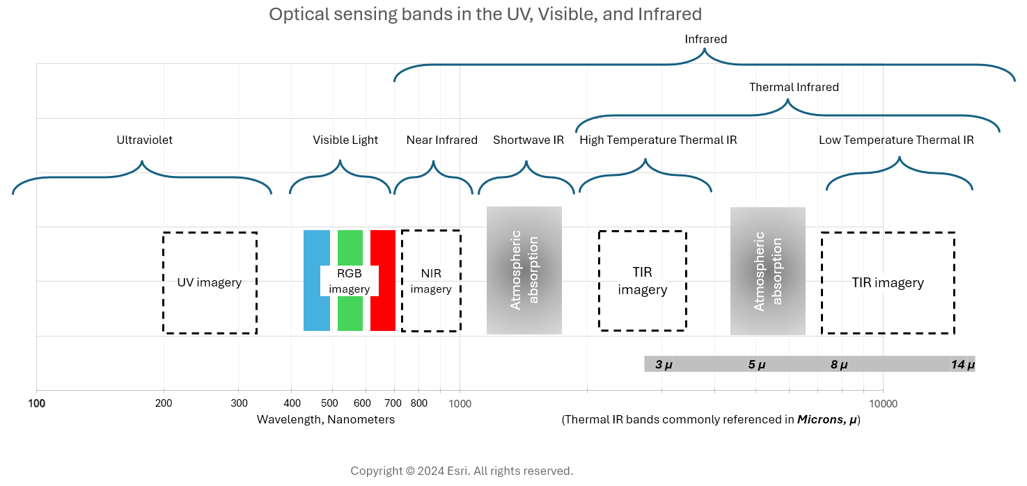

Note that we’re using the acronym “TIR” here to refer to the thermal infrared region of the electromagnetic spectrum. This blog does not address properties of near infrared (“NIR”) or shortwave infrared (“SWIR”) energy or sensors.

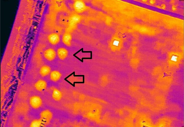

This application is growing rapidly since it provides a low-cost analytical method for a facility to reduce operational costs as well as environmental impact. Thermal infrared imagery is typically captured by a drone to view the rooftops of buildings under study, and areas that are losing energy can be easily observed as warmer or cooler than their surroundings. That is, if the outdoor weather is warm and the building has air conditioning, energy leaks will appear as cool regions. If the building is losing interior heat during wintertime, relative warm areas may be visible. Areas of the building that are noticeably cooler or warmer than their surroundings help building managers prioritize improvements to ventilation systems as well as locate and repair areas of insufficient building insulation.
Examples can be found in this publication from ACCESSiFLY. An example image (showing false colors applied to the single band TIR image) is shown here, highlighting warm regions around roof vents.

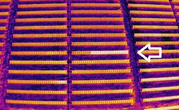

Another application where TIR imagery can provide value is by identifying equipment that appears to be overheating, indicating possible physical wear or failing electronics. This is applicable for a variety of types of equipment, including but not limited to photovoltaic solar arrays, electrical transformers, industrial motors, and more.
An example image is shown below, provided courtesy of Rocky Mountain Unmanned Systems. In this image, one section of the photovoltaic (PV) array is noticeably brighter (warmer) than the neighboring panels in the installation, indicating a possible defect in either the array or its control electronics. With prompt maintenance, the operator can reduce lost productivity and possibly avoid a more serious failure in the future.

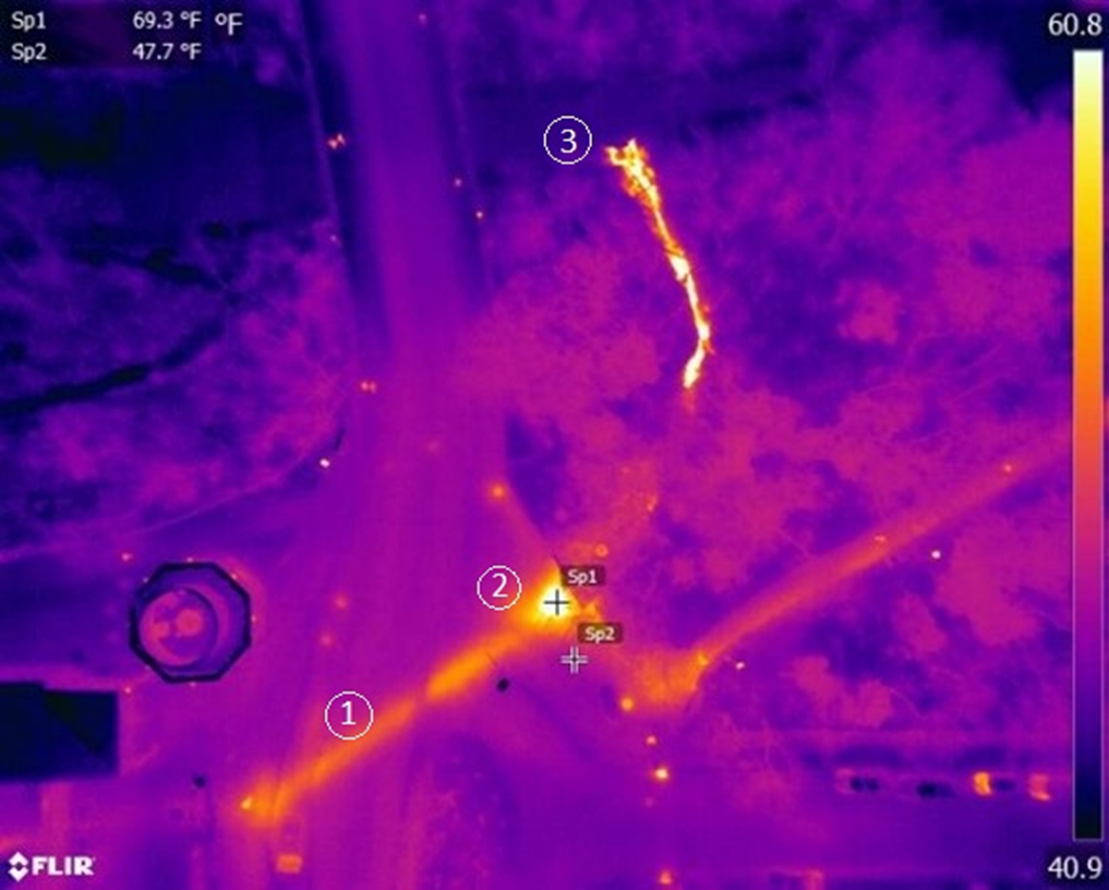

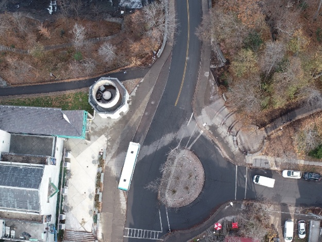

In the example images below (provided courtesy of EagleHawk) we can clearly see the route of an underground steam pipe (1 in the first image, TIR), with evidence of a condensate leak (2) entering a storm drain. In top center (3) we can see the warm water condensate running into a nearby ravine. The second image provides a natural color view of the same site. Based on this imagery, the leak was promptly located and corrected.
