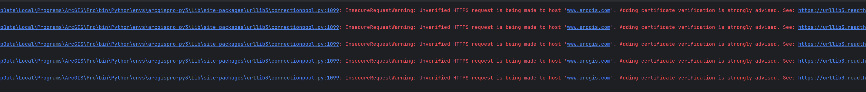

I have seen a lot of people asking if there is a way to see how many maps a layer is in. As an administrator, there is definitely some frustration in deleting layers and then finding out you didn't replace it in all of the maps. I think this script is a step in the right direction but it is not perfect, I receive a InsecureRequestWarning and Adding Certificate verification is strongly advised with the webmaps names under the warning.

Here is what you need to watch out for:

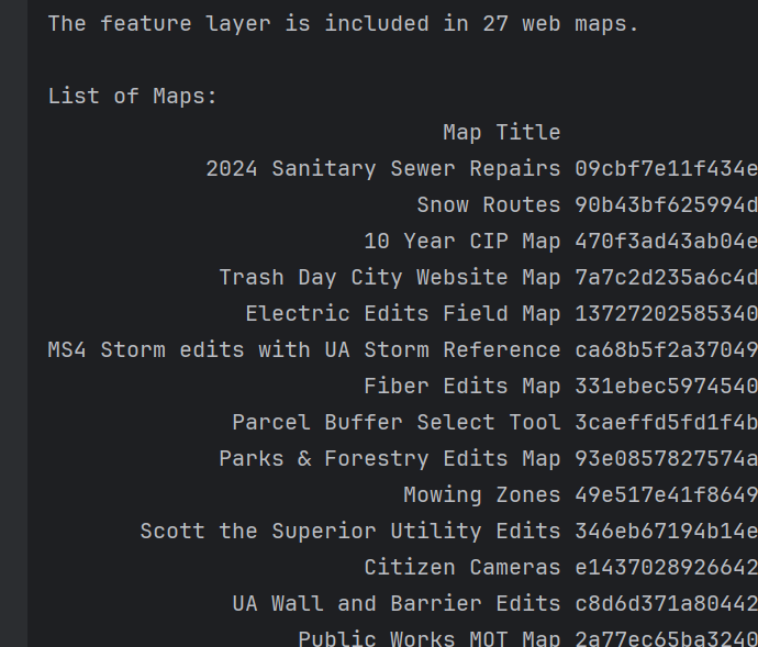

Here is a partial screenshot out the printed message:

map_count, map_list = search_and_count_maps(feature_layer_item)
# Print the result
print(f"The feature layer is included in {map_count} web maps.")
# Optionally, create a DataFrame to store more detailed information
if map_list:
df = pd.DataFrame(map_list)
print("\nList of Maps:")
print(df.to_string(index=False))
else:
print("No maps found for this feature layer.")
