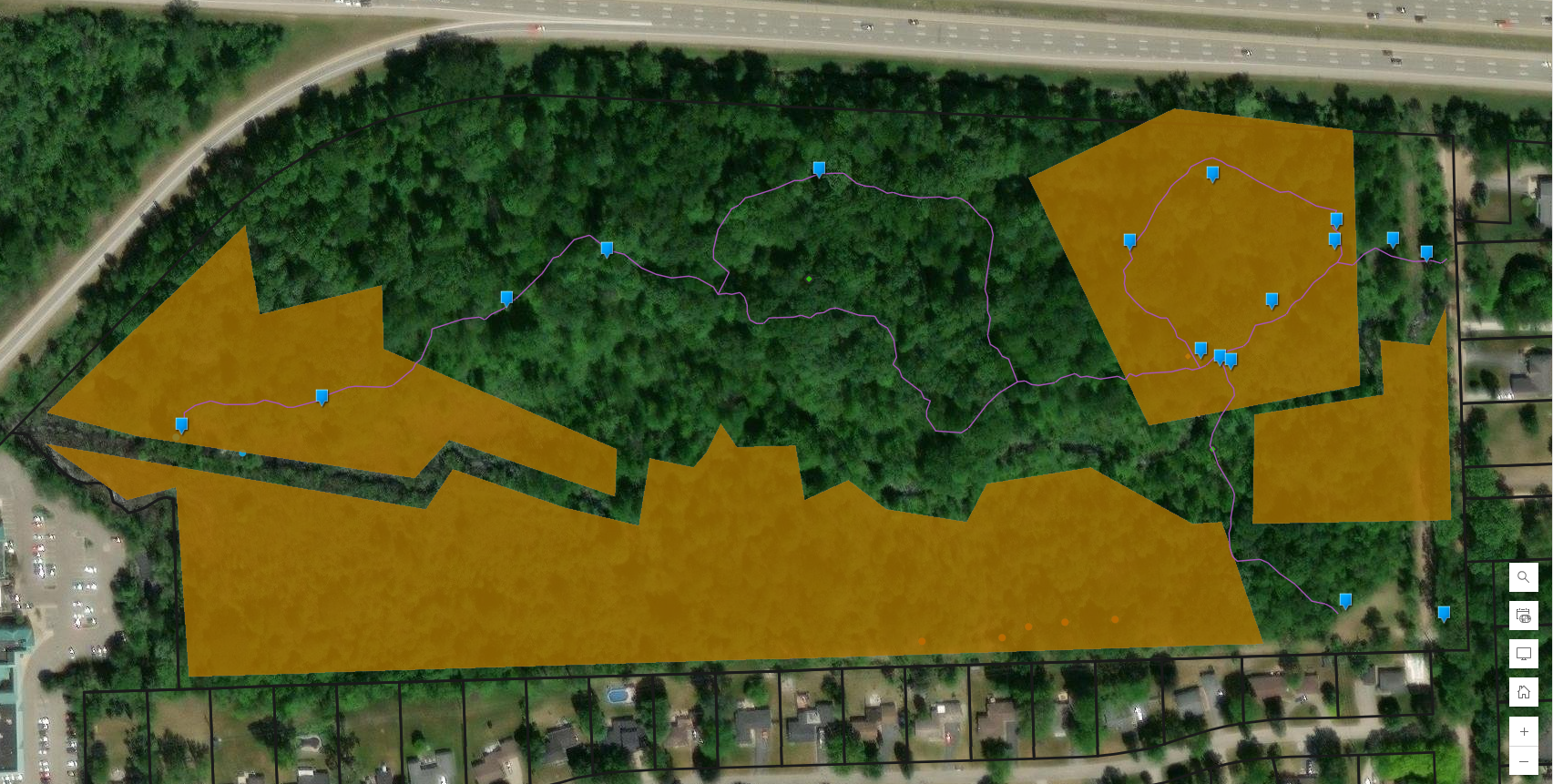

After the field data collection, we opened a copy of the recorded attributes on ArcGIS Pro. Figure 2 shows all of Nels Kimball Sanctuary’s unrefined point, line, and polygon features, including the trails and access points recorded for the trail map:
Figure 2. Collective unedited geodata of Nels Kimball Sanctuary

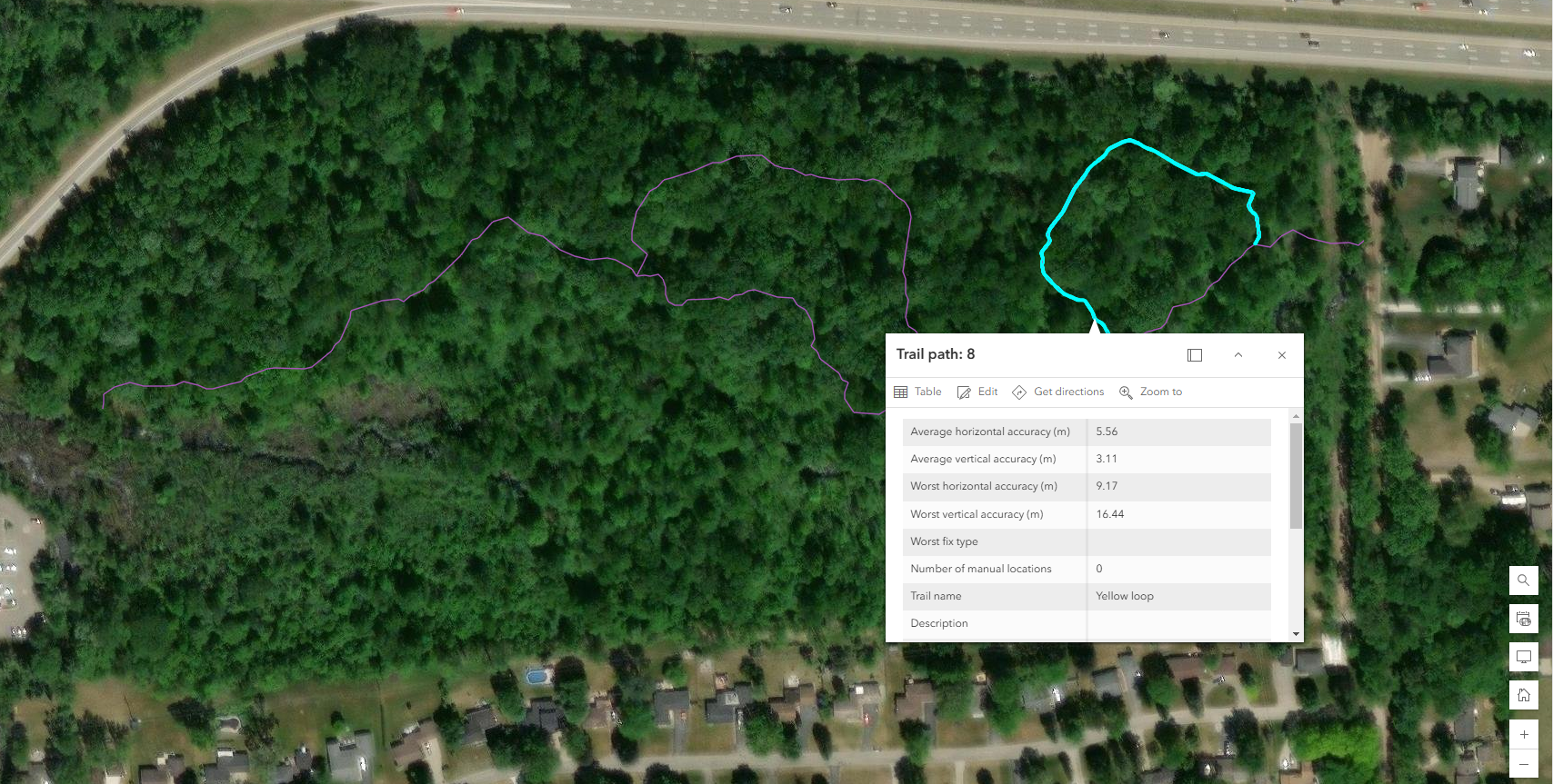

Because we wanted to create an interactive web map, we used Configure Pop-ups to edit the type of information that shows up when viewers click on each feature on the map. Figure 3a shows the default pop-up window for the Yellow Loop, and Figure 3b shows the same pop-up after edits were made to improve its appearance and include relevant information on the trail.

Figure 3a. Yellow loop pop-up before editing
Figure 3b. Yellow loop pop-up
after editing

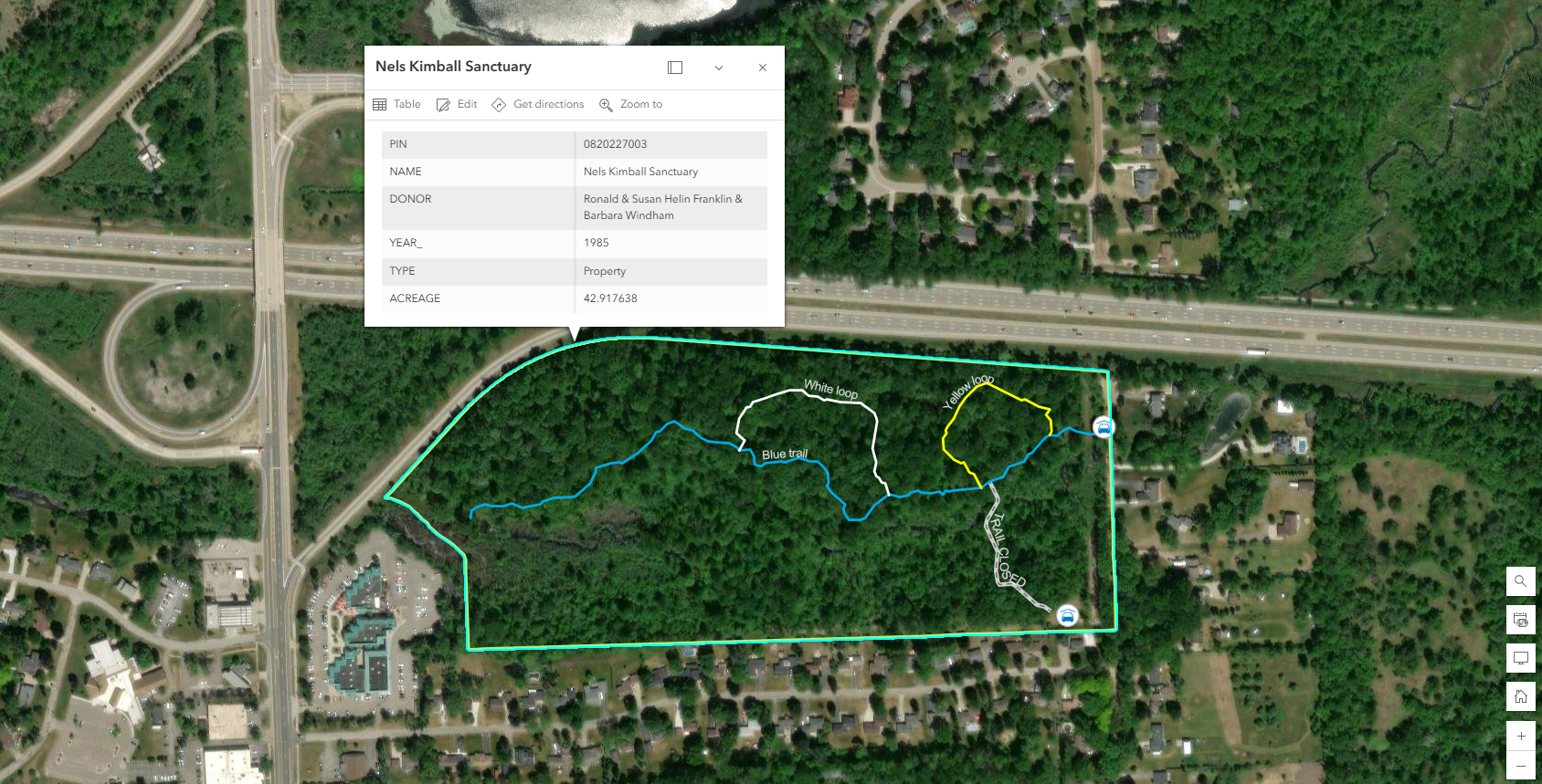

Figure 4. Final web map for Nels Kimball Sanctuary and the property pop-up window
View the web map of Nels Kimball Sanctuary here
