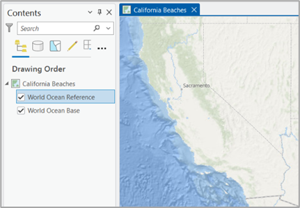

To set up for this process you open up ArcGIS Pro, create a map, and change its basemap.
Start ArcGIS Pro without a template.
From the Insert tab, Project group, insert a new map and change its name to California Beaches.
From the Map tab, Layer group, change the basemap to Oceans and zoom in to California.

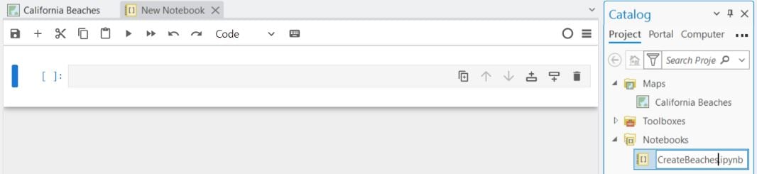

In ArcGIS Pro, from the Insert tab, Project group, insert a new notebook.
In the Catalog pane, change the notebook name to CreateBeaches.ipynb.
The new Notebook has a blue outlined cell. Python code is written and organized into cells.

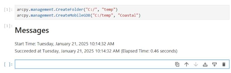

Add the following code into the cell. If you copy and paste, use CTRL+V to paste the code into the cell.

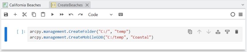

arcpy.management.CreateFolder("C:/", "temp")
arcpy.management.CreateMobileGDB("C:/temp", "Coastal")
Left of the cell you will see empty square brackets [ ], when you run the code you will see a star inside [*]. After the code successfully runs you will see a number inside [1].
The code above uses arcpy to run the CreateFolder and the CreateMobileGDB tools from the Management toolbox. The syntax arcpy.toolboxname.toolname can be used to run any of the over 1,600 tools in ArcGIS Pro.
When your notebook matches the code in the one above, click the Run button to create the Coastal mobile geodatabase in your c:\temp folder.
After a code cell runs it turns gray. Messages report run time or errors.
Under the messages a new empty cell is ready for more code. Cells contain manageable blocks of Python code that you can write and run independently (or all together). When a cell has the blue outline, it is the active cell and its code will run if you click the Run button.

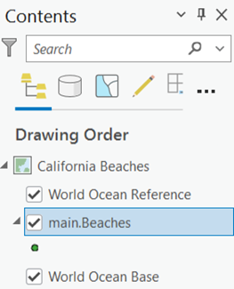

When the cell finishes running, in the Catalog pane, navigate to the C:\Temp folder to confirm the geodatabase and feature class are both there.
Coastal.geodatabase is stored as a single file. Mobile geodatabases use the open-source database format called SQLite. The main.Beaches feature class uses the SQLite naming convention.
Look in the Contents pane to see the Beaches layer on the map.

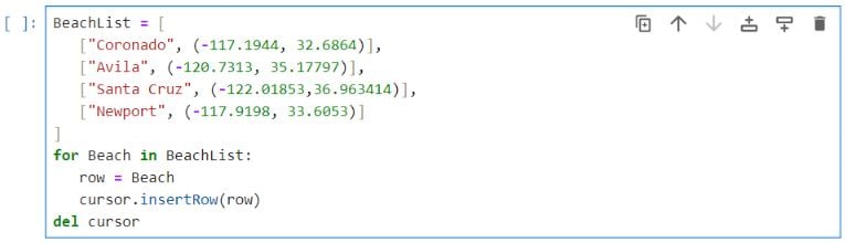

The InsertCursor can add one record at a time as shown above, however when structured inside a looping routine many records can be added in one shot!
In the Notebook’s fifth cell add the following code. Take notice of the for loop and how it has two indented lines. If you copy and paste that indent might be lost. Before you test run the cell ensure that your indenting looks that that shown below.
BeachList = [
["Coronado", (-117.1944, 32.6864)],
["Avila", (-120.7313, 35.17797)],
["Santa Cruz", (-122.01853,36.963414)],
["Newport", (-117.9198, 33.6053)]
for Beach in BeachList:
row = Beach
cursor.insertRow(row)
del cursor
The first lines (1 to 6) represent a list of beaches where each beach has its own unique list containing a name and a tuple for the pair of the WGS84 coordinates. The for loop (lines 7 to 9) goes to each beach in the list and adds it into the Beaches feature class. When the cursor is done doing its job the best practice is to remove it from memory using the Python del statement.

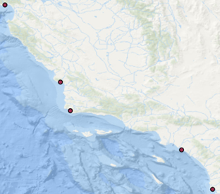

Click the Run button to add four more beaches.

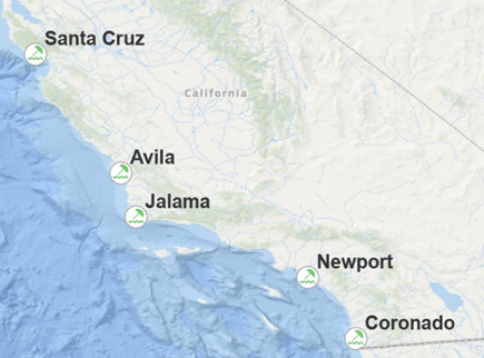

Bring the map to the front to see the beaches! If the beaches don’t appear zoom in and out on the map to refresh. The point symbols are small and hard to see. Size and color change is next.

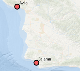

This code navigates to the current project, gets the map, gets the beaches layer, and changes label expression to the BeachName field, and finally turns on the layer's labels.
Run the cell.
Bring the California Beaches Map to the foreground to see labels on all five beaches!

Bring the California Beaches Map to the foreground to see the color and size changes.
Congratulations! You just added a feature to a feature class using an arcpy cursor.
