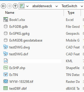

In the screenshot below, I have several layers and views pointing to data of the following types:
- TINs
- File Geodatabase Vector and Tabular Data
- Mobile Geodatabase Vector Data
- CAD data
- Excel Data
- Shapefiles
- KMLs
Here's the thing. All of these data sources, as you can see, are in the same folder.

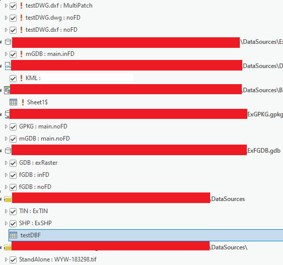

| Thing repaired | Yield | Picture for proof |
| DBF or SHP or TIN or file Geodatabase Contents or standalone rasters | - SHP,
- TIN,
- DBF,
- Standalone raster datasets
- File Geodatabase feature classes and tables
- Also caused graphical bug where the broken file geodatabase persisted despite having nothing pointing to it.

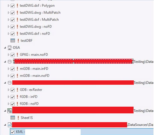

| CAD data | - SHP,
- TIN,
- DBF,
- And exactly one repaired CAD layer, even though there are 10 others in the same place

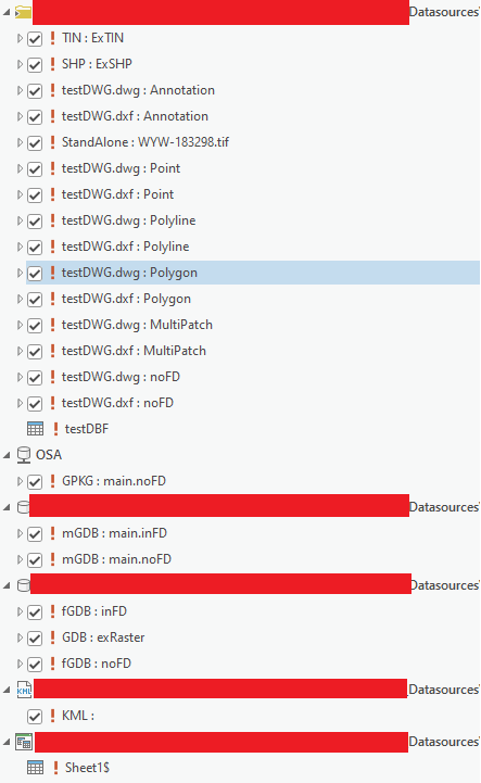

| Mobile geodatabase | - SHP,
- TIN,
- DBF,
- Mobile Geodatabase contents

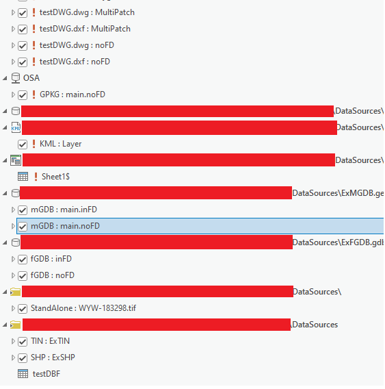

| Geopackage | - SHP,
- TIN,
- DBF,
- Geopackage contents
- Also mistakenly repaired the link for layer pointing to a feature class of the same name in a mobile geodatabase

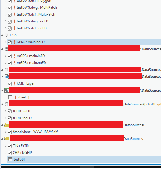

| Excel Sheet | - SHP,
- TIN,
- DBF,
- That Excel sheet
