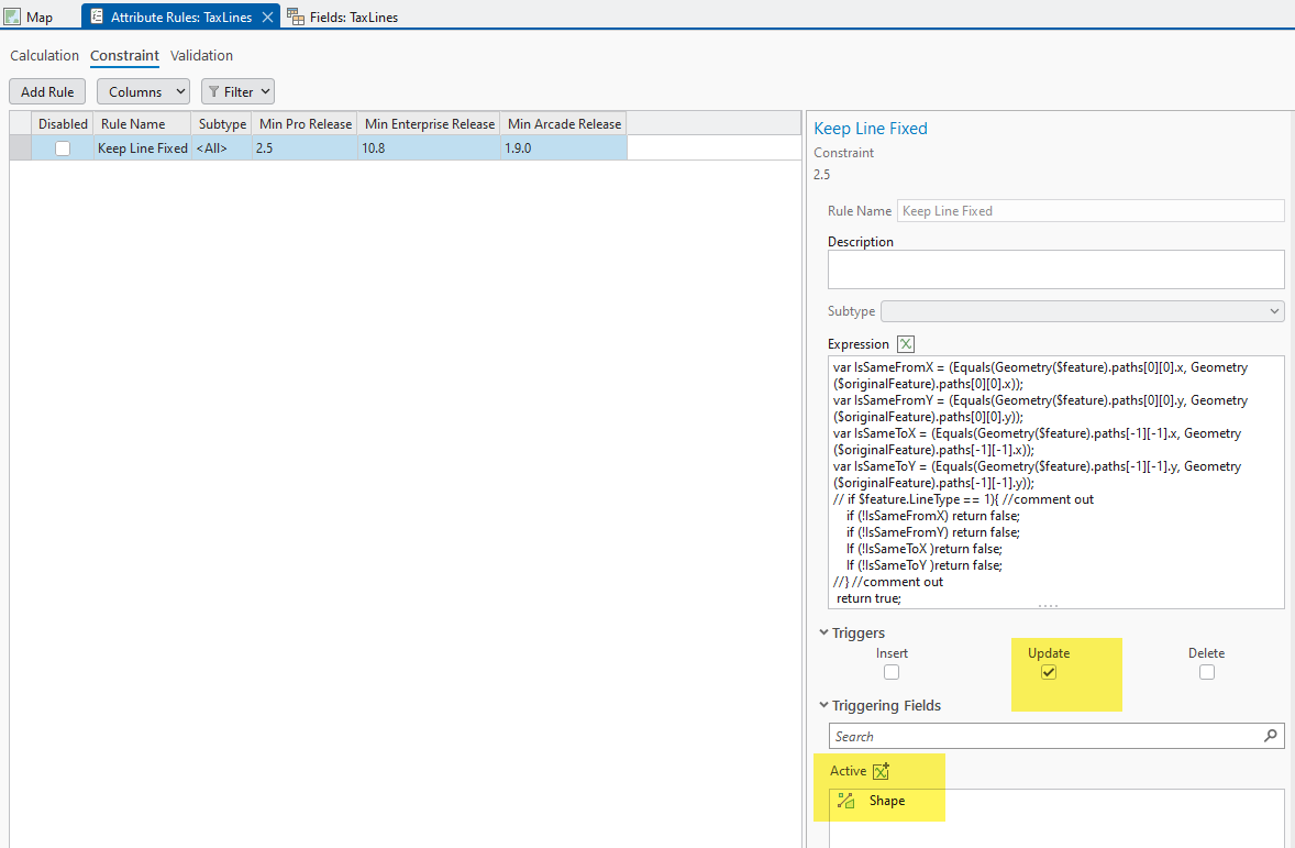

Yes - here is a sample you can use. It checks that the start vertex and the end vertex do not changes during an edit by comparing their X and Y coordinates.
You can probably condense this expression and adjust it to your specific lines:
var IsSameFromX = (Equals(Geometry($feature).paths[0][0].x, Geometry($originalFeature).paths[0][0].x));
var IsSameFromY = (Equals(Geometry($feature).paths[0][0].y, Geometry($originalFeature).paths[0][0].y));
var IsSameToX = (Equals(Geometry($feature).paths[-1][-1].x, Geometry($originalFeature).paths[-1][-1].x));
var IsSameToY = (Equals(Geometry($feature).paths[-1][-1].y, Geometry($originalFeature).paths[-1][-1].y));
// if $feature.LineType == 1){ //comment out
if (!IsSameFromX) return false;
if (!IsSameFromY) return false;
If (!IsSameToX )return false;
If (!IsSameToY )return false;
//} //comment out
return true;
To use this in an attribute rule make sure to only trigger it on 'Update'. If you are using ArcGIS Pro 3.4 and above, limit the attribute rule to get triggered when the SHP field is modified.
