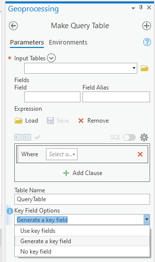

ArcGIS Pro 2.9.5; file geodatabase
The Make Query Table geoprocessing tool can generate an OBJECTID column on the fly (dynamic).
If the tool could sort (descending) on a field like POPULATION before generating the OBJECTID column, then that might give us a way to solve the "FGDB: select cities with top 4 population" problem: What tool can select the records with the highest values in a particular field? We could do a Select By Attributes WHERE OBJECTID <= 4.
That wouldn't work on the unsorted source table, but it would work on the Make Query Table feature layer since the data was sorted (descending) by POPULATION, and then an OBJECTID field was dynamically generated afterward.
Could a Sort (Ascending/Descending) geoprocessing parameter be added to the Make Query Table geoprocessing tool?
