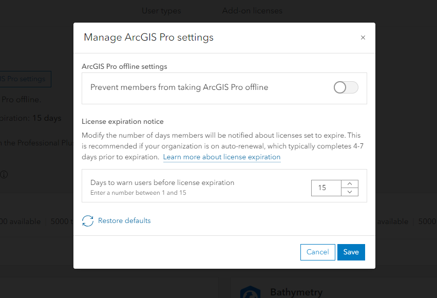

First and foremost, offline licensing of ArcGIS Pro should be enabled from within the licensing ArcGIS Online organization.
This setting can be found under ‘Licenses’ in ArcGIS Online and then ‘Manage ArcGIS Pro settings’:
This is currently a ‘global’ option. Administrators can enable/disable ArcGIS Pro offline licenses for the entire organization, but there is no way to enable this capability for a specific role, user, or group. A request for this capability has been logged with Esri’s product team.

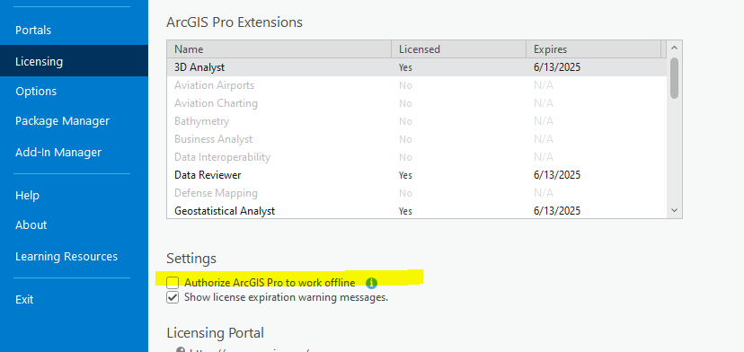

If ArcGIS Pro is available for offline use – users will see the option available under Settings, Licensing, Authorize Pro to work offline:
When users ‘tick’ this box, they can take ArcGIS Pro offline for the duration of their license term. A future enhancement to ArcGIS Online will allow administrators to set the length of time that a license can be checked out for.

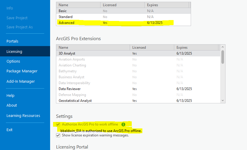

In the screenshot below – I have taken ArcGIS Pro offline. We can see that my Advanced license expires on 6/13/2025 and the username ‘bbaldwin_EIA’ is listed as the authorized user.
So – my user now has a license checked out on his/her machine – and they are good to go!
