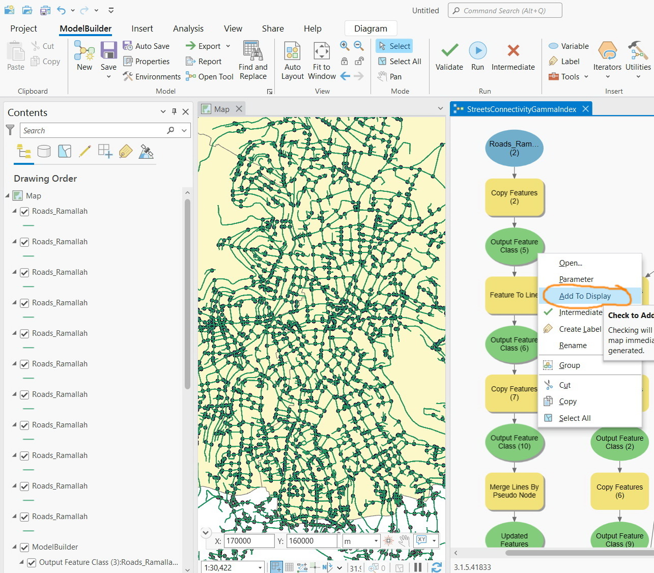

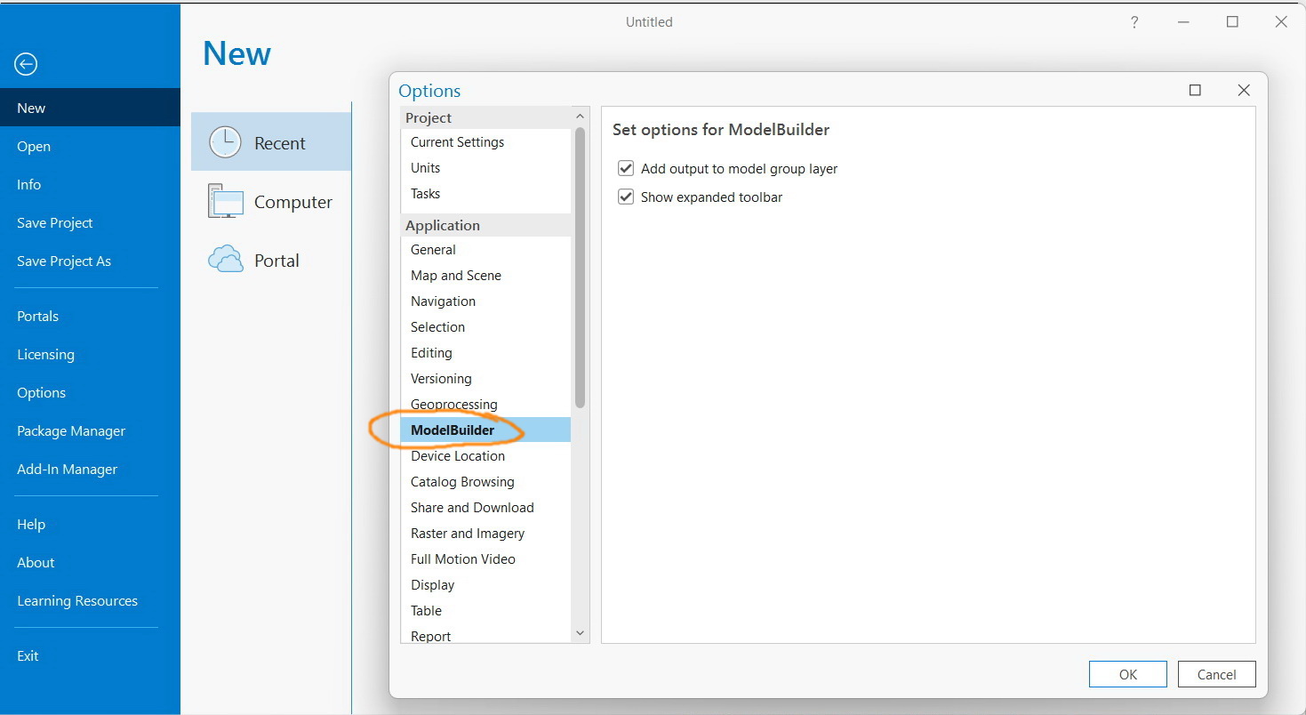

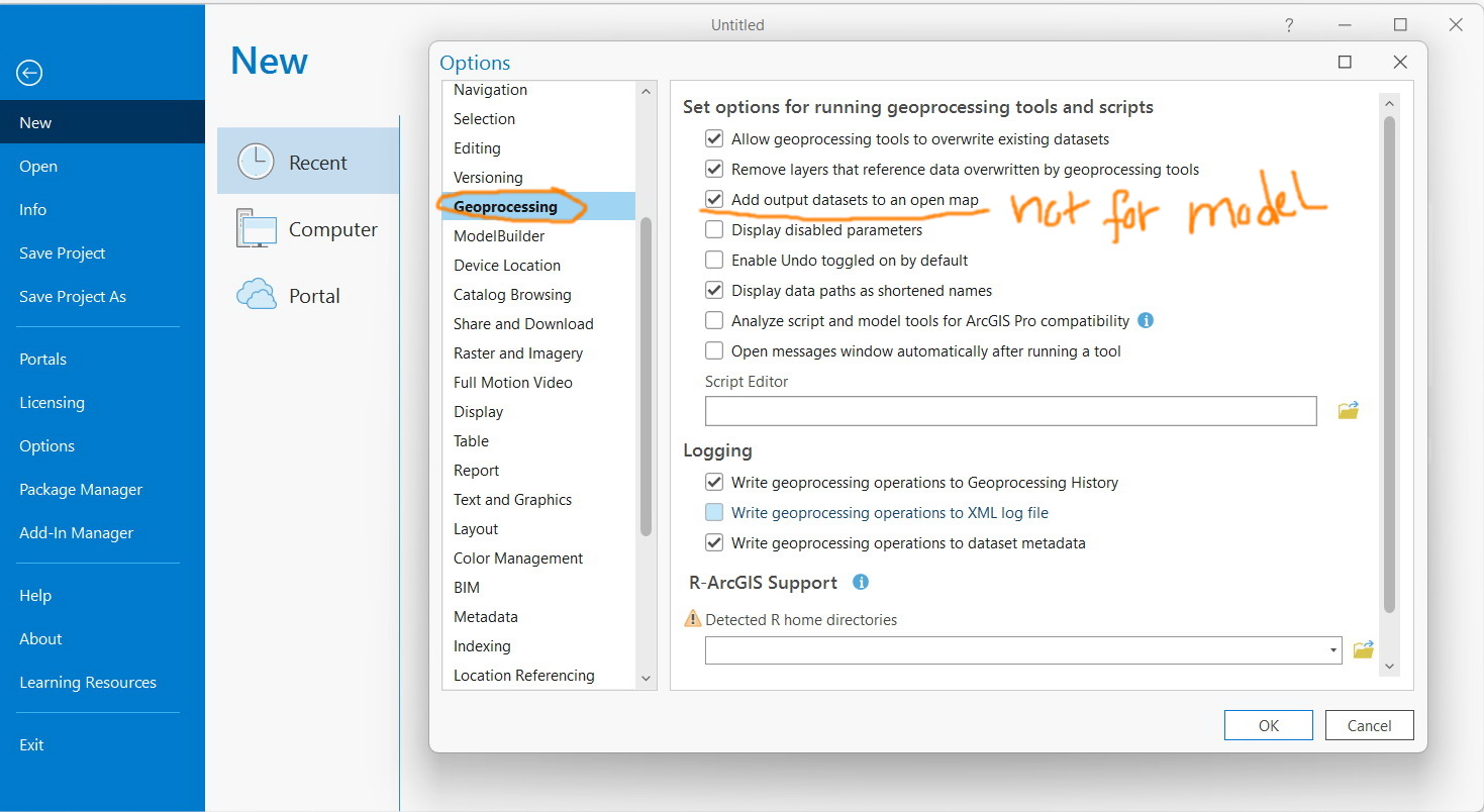

ArcGIS Pro 3.1.5: A setting option to automatically add the output of a model builder tool to the table of contents,
Currently, there is no setting option to automatically add the output of a model builder tool to the table of content. We always need to manually right-click the output layer in the model and then check the “add to display” option.
It would be great if this option were available at the settings level.
